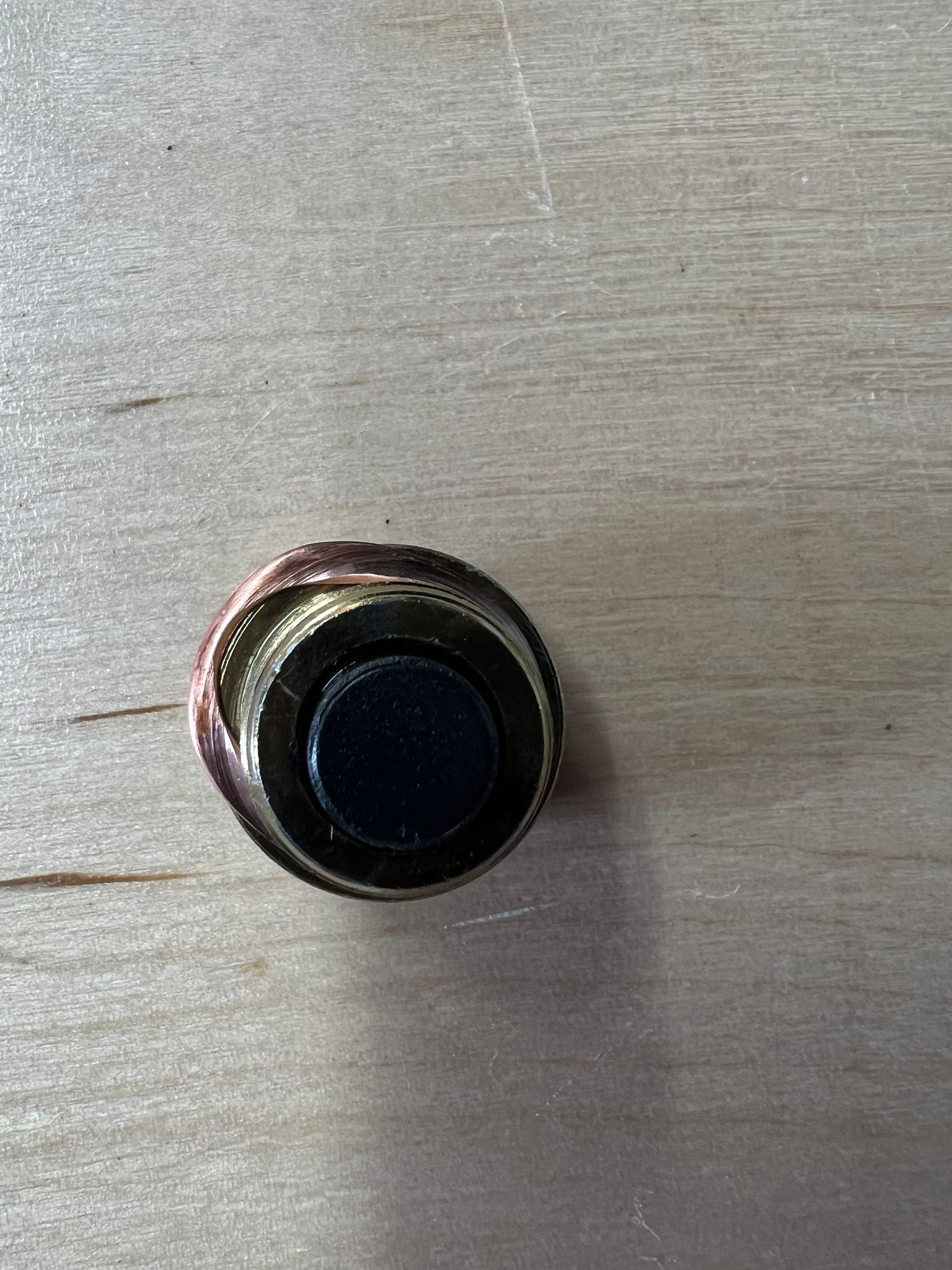

I hope it's OK to in effect resurrect this post which I began some 12 months ago or so. Assuming it is, may I seek some information please.
Attached is an image of the oil drain plug of my bike, you'll notice there is a small pool of oil directly below it which has never happened before and has not happened since I tightened it after filling the bike with oil last year.
I've checked and it appears to me that the oil is coming from the oil drain plug.
I'm wondering, is this a common occurrence?
For information;
1. I was able to tighten the plug a little after I noticed the initial leak
2. Since the tightening, then it didn't leak BEFORE I took the bike out but it DID after I took it for a short ride out
This oil drain plug and crush washer were brand new ready for when I changed the oil and filter last year.
My current theory is that the crush washer has perhaps split and so is not able to do it's job.
What do you guys think and what would you do in their circumstance?
Thank you very much for any advice that you may be able to share.
WhatsApp Image 2025-04-24 at 14.22.52_17151bd6.jpg (263.79 KiB) Viewed 12145 times
1990 BMW R100RS
Posts: 1376
Re: A leaking oil filter cover.
Observations...
1) That doesn't appear to be a 'stock' drain plug (which is an allen plug). May have nothing to do with the issue... can't really say.
2) The sealing washer 'should' be replaced every time it's removed. You can sometimes get away with annealing copper washers and removing them but if you don't replace, it's not unusual to get leakage from this point.
3) If, after replacing the washer, the issue doesn't go away, you need to examine the mating faces on the plug and the sump. if the sump face is damaged slightly, it can be salvaged by facing it up. If the plug face is damaged, the best remedy is to replace the plug.
4) If all else fails, you need to look at the sump casting to see if there are any cracks.
mralistairjones
Posts: 22
Joined: Tue Jun 18, 2024 12:01 pm
Location: Wirral, UK
Post by mralistairjones »
Hi Rob
Thank you for your reply.
The sum plug was provided by Motobins to replace the original. It is the recommended replacement for the original. When it was fitted I put a new washer on at the same time. The mating faces maybe the problem but it’s strange that this has started happening some 9 months after the plough was last removed.
I tend to agree that a replacement washer and plug may resolve this small problem as looking around the casing I’m certain the oil is coming from the underside of the plug.
Thanks again for your reply, much appreciated.

And the answer is ... a misshaped crush washer. :D
Thank you for your assistance!

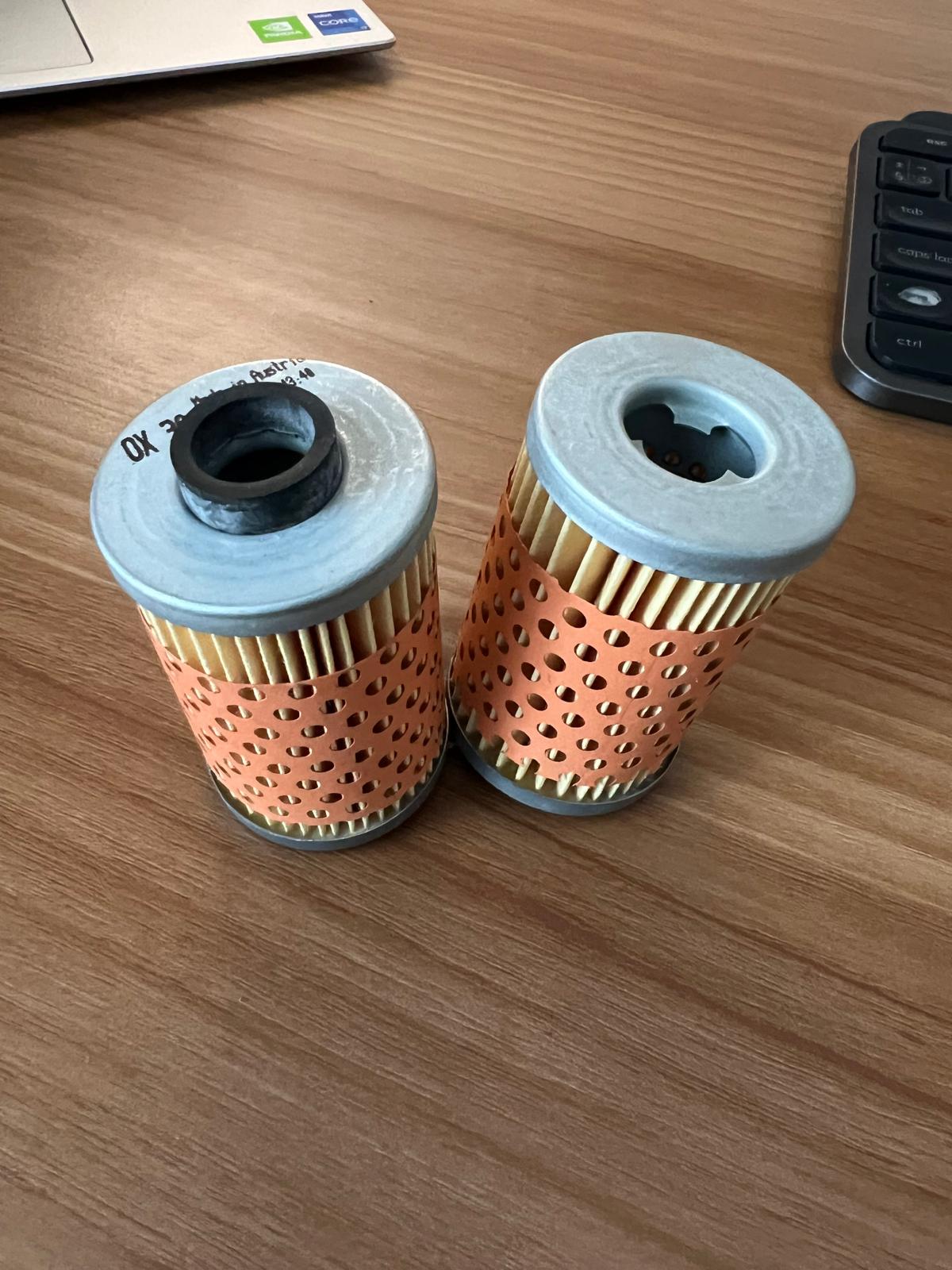

WhatsApp Image 2024-06-19 at 19.05.36_92bf00ef.jpg (230.8 KiB) Viewed 9214 times
This mornings job was an oil and filter change on my R100R. The filter removed was the same as the above, the replacement from Motobins has the rubber seals both ends. It all went together without any problems but am now wondering if the rubber seal at the cover end is partially blocking the feed and return holes as shown in the second image for the oil cooler. Any comments?
WRONG FILTER!!
DO NOT START THE ENGINE!!! replace it right away with the one pictured.
part # 11 42 1 337 575
