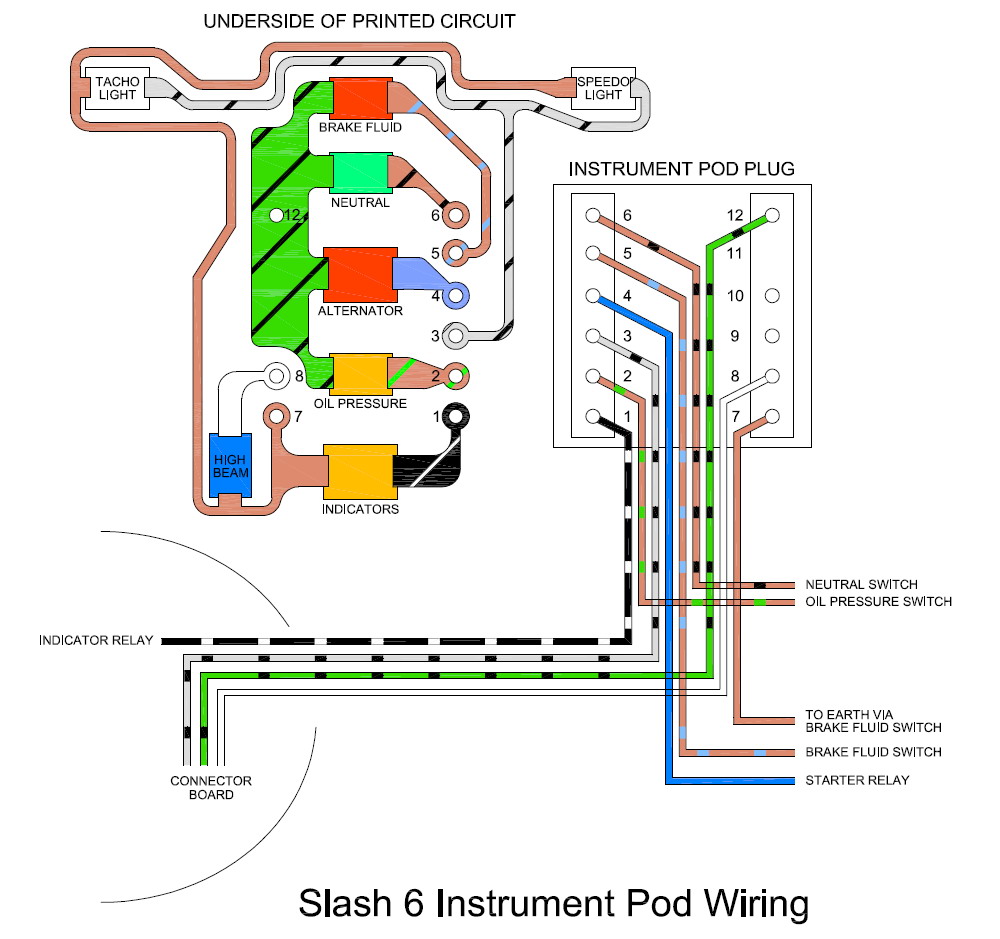

And here's my 'map' for the '74 instrument pod:
SLASH SIX POD 150727.jpg (148.34 KiB) Viewed 48645 times
I hope these will be useful to you.

No one appears to have said it yet but the wiring on Euro spec /6 machines (and many others) is different to that used on US spec /6 machines. Also '74/'75 machines are VERY different to '75 and '76 machines. Not sure where you're based but unless you know what you're looking for, you have a 1 in 4 chance of a random /6 diagram being right for your bike.
Be a bit wary of the diagrams published for airheads in any case. Very few of them are completely accurate... and that includes those produced by BMW themselves. For example in the diagram above:
1) there are two blue wires shown sharing a single terminal in the starter relay. As you are aware, each of the wires , has in fact got it's own terminal. Makes no difference electrically but it's enough to cause confusion if you're not sure what's going on.
2) The wire from the ignition switch (or lights on/off switch where fitted) to the light dip switch is shown as solid yellow. BMW and other diagrams all show this is yellow with a white tracer (except Clymer which shows it as green at one end and yellow/white at the other :?: ).
When working on airhead electrics, a basic knowledge of electrickery is very useful. As an electrical engineer, you should be fine as long as you treat (all) wiring diagrams with a small pinch of salt!
