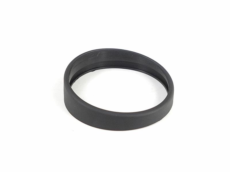

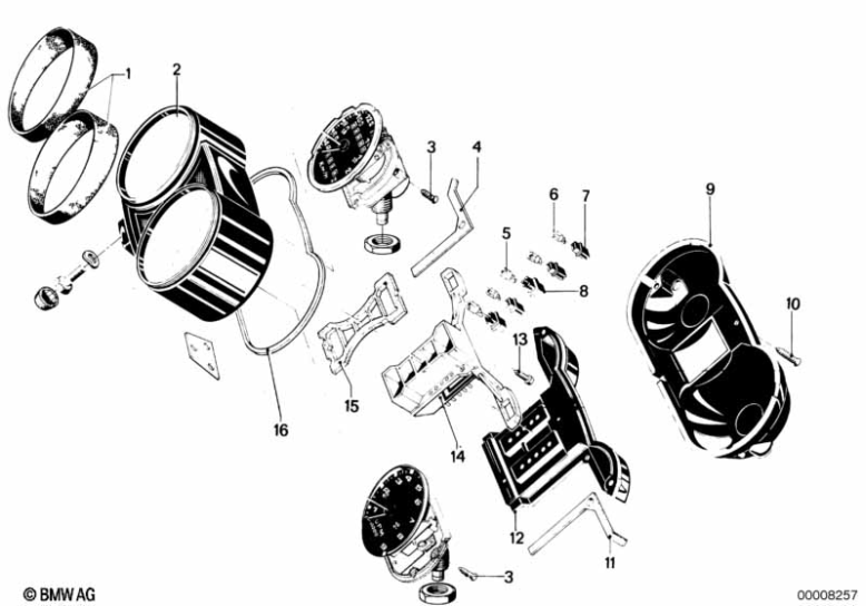

The rings/shrouds on my RS/S conversion won't stay put. It looks like a PO has replaced the glass at some point and the indent around the interface between glass and housing is uneven. The shrouds which were on the bike at purchase fell off on journey home from the vendor but luckily I managed not to lose them. They are showing their age, and have lost much of their elasticity.
image from the MAX BMW Motorcycle mirofiche, part no.1
Interestingly it is recommended to glue them in place when replacing, in which case I see little point in purchasing new replacements.

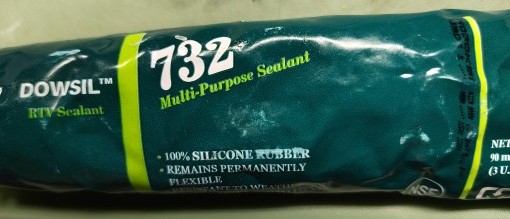

I've used Dowsil 732 with success on glass and 'eyebrows' on the instrument cluster. Stays flexible so not permanent.
Dowsil 732.jpg (35.88 KiB) Viewed 23452 times

Thanks both, I've a tube of silicone somewhere I'll dig out.
