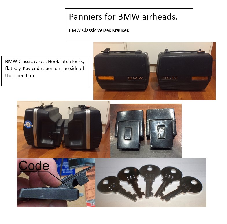

BMW panniers.jpg (110.2 KiB) Viewed 9473 times
Latch key?

First point... these aren't Krauser Panniers, they are BMW 'touring' panniers as supplied from about 1983, BMW supplied Krauser panniers as OEM until around 1984 but then changed to their own branded luggage.
Second Point... the S150 keys fit Krauser Classic Panniers and not the touring type.
It's worth finding the key numbers... (see post above) the number will be three digits starting with 0... and asking around to see if anyone has a spare. Hopefully, all of your pannier locks use the same key.
It's reasonably easy to rekey these locks and even produce spare keys if you're reasonably adept with a small saw and file. This might be of use https://robfrankham.com/pannier-latch-refurb. As you will see above, allof the keys have the same profile, it's the section of the key shank that provides the security (if you can call it that).

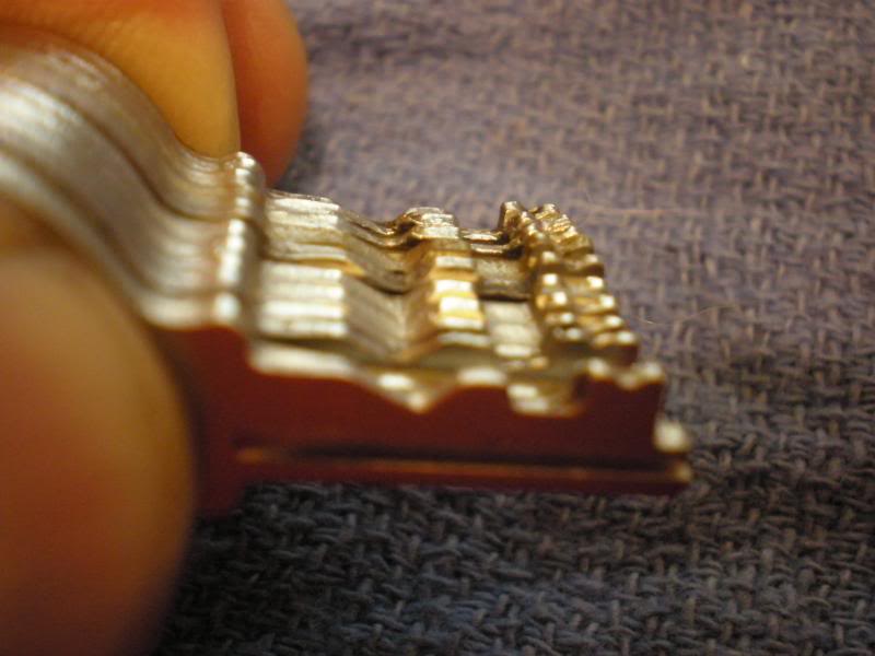

Rob Frankham wrote: Thu Nov 20, 2025 6:33 am First point... these aren't Krauser Panniers, they are BMW 'touring' panniers as supplied from about 1983, (yep, showing the difference. A picture confirming what the OP has would be helpful, as I've often read the panniers described as Krauser when they were BMW and vice versa. I had BMW panniers supplied on my first R100RS and 1983 R65LS Rob) BMW supplied Krauser panniers as OEM until around 1984 but then changed to their own branded luggage.
Mscutts wrote:The lock type is the one with the small rectangular cover.
Sounds like the BMW locks?
(Looking for clarification here from the OP...the Krauser S150 is a shaped key verses the flat BMW key above. You're right about asking around as the best way to find a replacement, once the identity of the key is confirmed. Motobins etc don't supply them singly, nor do they supply a lock to suit whatever key a buyer might have. They sell whatever lock and key they grasp off the shelf to fill the order.)
keys panniers.jpg (44.23 KiB) Viewed 9339 times

Thanks chaps, some great info there. Based on this I can confirm I do have the BMW touring panniers. I searched what I thought was every inch of the latches but couldn't find the codes. Now I know they are 054 for the top latches and 057 for the latches that attach to the frame.

The cut profile for the keys for the BMW motorcycle panniers from the 1980's is identical across all numbers (I believe, as per the picture above). The difference is in the keyway/longitudinal profile of the key shaft.
