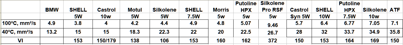

Posts: 805
Re: Fork Oil
Rob Frankham wrote: Sat Jan 17, 2026 6:14 am The 'W' rating of fork oil is not actually very helpful, except in general terms. It describes the viscosity of a given oil at 0 degrees c and has little bearing on the performance at any other temperature. BMW recommended specific oils for forks varying between 2.5W and 10W with many that didn't quote a 'W' rating at all. Most of these oils are no longer made. In general, most users find an oil somewhere between 5W and 10W is best but it is a good idea to do some experimentation to find what suits you. Once you have it, stick to viscosity and brand for consistency.
FWI, I find a 7.5W produced sold at the local auto spares store (Halfords in the UK) works as well as any and that's what I stick to.
Fork oil manufacturers use of the W designation is even more misleading than that.
For normal multigrade oils, W officially stands for winter and it it's a measure of viscosity at very cold temperatures.
Fork oil manufacturers seem to be using W for weight which has no official meaning. What they are doing is using W as an approximate indication of the the viscosity at 100 Deg C which is not helpful either. What I always do to compare forks oils is look up the data sheets to find the viscosity at 40 Deg C which is much closer to real world operating temperature.
Screenshot 2026-01-17 124434.png (18.88 KiB) Viewed 7149 times
Posts: 1737
Re: Fork Oil
Sort of like selling Cheetos without any real cheese!! ;)
