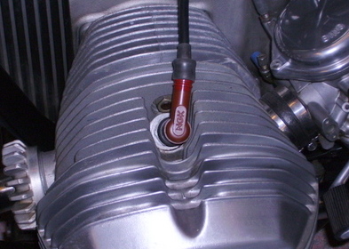

You mean like this. Home made variety on the right for cleaning between the fins.
...and the result. Not as good as blasting but not bad.
