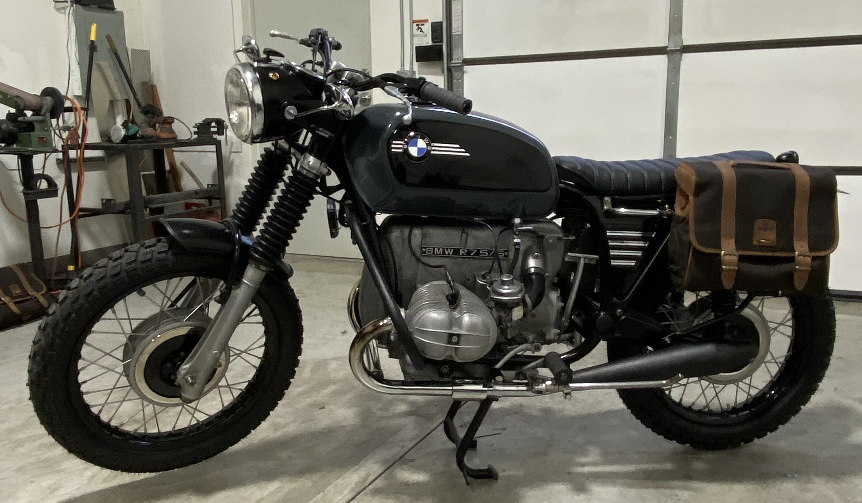

Hey all, meant to update this. My issue was an install error. I accidentally installed the brush holder fiber washers so it was grounding out to the housing. Fixed and running great.
