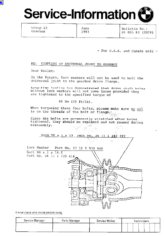

I have the original Service Information 26 002 83 (in PDF).
The new length is 13 mm (14,5 mm before).
BMW says to renew the bolts each time (tighten at 40 Nm torque).

DP55 wrote: Sun Jan 23, 2022 12:27 pm I have the original Service Information 26 002 83 (in PDF).

Earlier in the thread, someone mentioned Bulletin 2078. Here is a screenshot of that bulletin...
