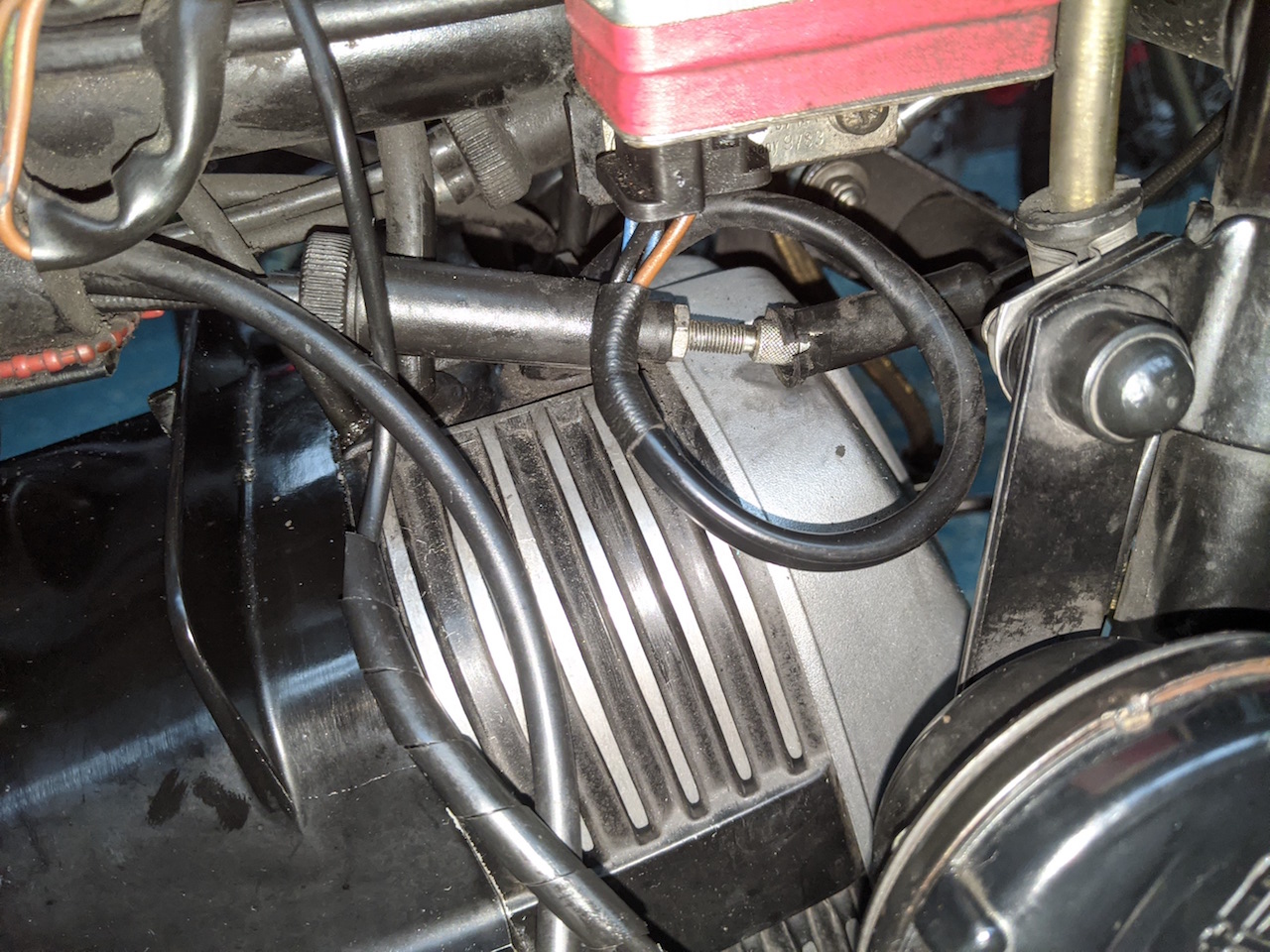

Here is a shot of my throttle cable split-er. Rubber cover is ripped. Do these split-ers normally need replacing?

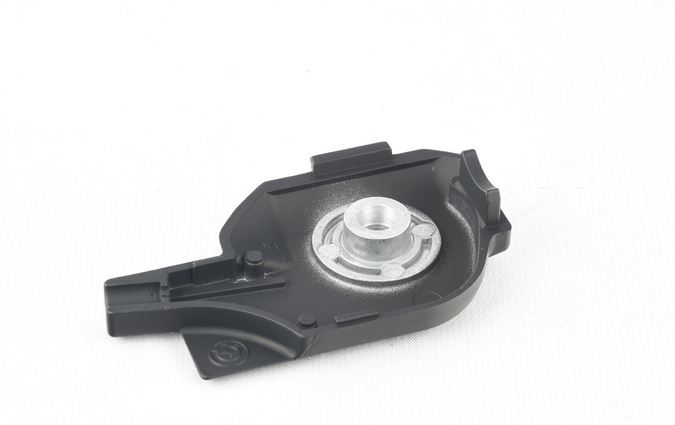

I fear that the replacement gear and top will be required... I don't think BMW have supplied the old type for a long time. It's not a completely bad thing because there is a tab on the cover that fits into a groove on the twistgrip tube and holds the tube in place on the bar. This is also subject to wear and when it does, it allows the twistgrip to move outwards on the bar increasing wear at the gear.
As far as cables go, if they are smooth, unfrayed and the outers are sound, why change them? The life of a cable depends on a it's use and the care it's received. There is no set life. Examine them... if they're good, use them. Any replacement cables you get will probably have nylon sheaths on the inner cable. These can be a two edged sword. On one hand, you don't need to lubricate them so they are low maintenance, on the other you shouldn't lubricate them so they can suffer more from water ingress with the associated rusting issues and, when the nylon sleeves wear out (as they do), then they can be troublesome.
It's a good idea to change the rubber cover... it protects the adjuster and, to a certain extent, stops it from working loose. They are easy enough to source and you can probably get a perfectly satisfactory one from any bike parts store if you don't want to go BMW.
Getting the cables oput of the splitter can be a knack. On first examination, there doesn't seem to be enough play in the cables to allow them to be removed... however... the trick is this:
1) Loosen off the cable adjuster on the splitter as far as it will go.
2) Unscrew the cap and pull the twin cables out to the farthes extent. It's possible to do this with the cables connected but MUCH easier if they are disconnected at the twistgrip and the carbs.
3) Push the slide back into the splitter so that the single cable is protruding from it. The nipple should now be clear of the body. Move the end of the cable with the nipple sideways in the slot in the slide until the nipple is clear of the slide, then pull the slide out with the cable sliding through the slot.
Like most knacks, once you have done it once, it's easy.

My cap doesn't have the "bump up shown in this pic of the new model below.
