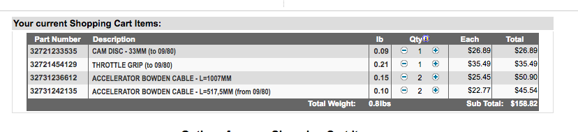

Thanx! Not easy to find these parts. Moto bins seems to be down. Is the throttle cam disc the same part on all the models?
- Posts: 1340
Re: Throttle feel
The wear on the teeth is normally quite visible if you clean off all of the grease... but if the feel is as bad as you say, then there's no need to see it, it needs replacing.
No the cam and chain are model specific. They also the differ dependant on whether the bike has one or two cables at the control. You need to get the set that fits your machine... Motobins and Motorworks websites are both up this morning but I'm sure there are shops your side of the pond that can help. BobsBMW comes to mind, they seem to get a good press though I've never used them.Zombie Master wrote: ↑Wed Feb 17, 2021 6:37 pm Thanx! Not easy to find these parts. Moto bins seems to be down. Is the throttle cam disc the same part on all the models?

Re: Throttle feel
Three points...
1) Do you know if you require a replacement cover for the bevel gear recess? The designed was changed, not sure when, and the older style cam disk and cover are no longer available. The later type work perfectly but only if you replace both.
2) I'm a bit confused about the cables. You either need three cables if the handlebar mount only accomodates one (i.e. one from the handlebar mount to the splitter under the tank and one to each carb from the splitter) or, if your mount accomodates two, you need two longer cables one for each carb. The arrangement varied by year. I think yours should be the arrangement with a splitter but I'm not sure.
3) If you do have a splitter, it's worth examining it to see that it's in good condition while you're changing everything else.
- Zombie Master
- Posts: 8828
Re: Throttle feel
Yea I should only need one cable to get to the splitter, I have to determine which part number that is. I'll have to measure the cam disc to see if I need a new cover. I'd like to get the OEM heated grips. I wonder how well they work. I could always install undergrip heaters. Are there switched accessory jacks in the headlight?
