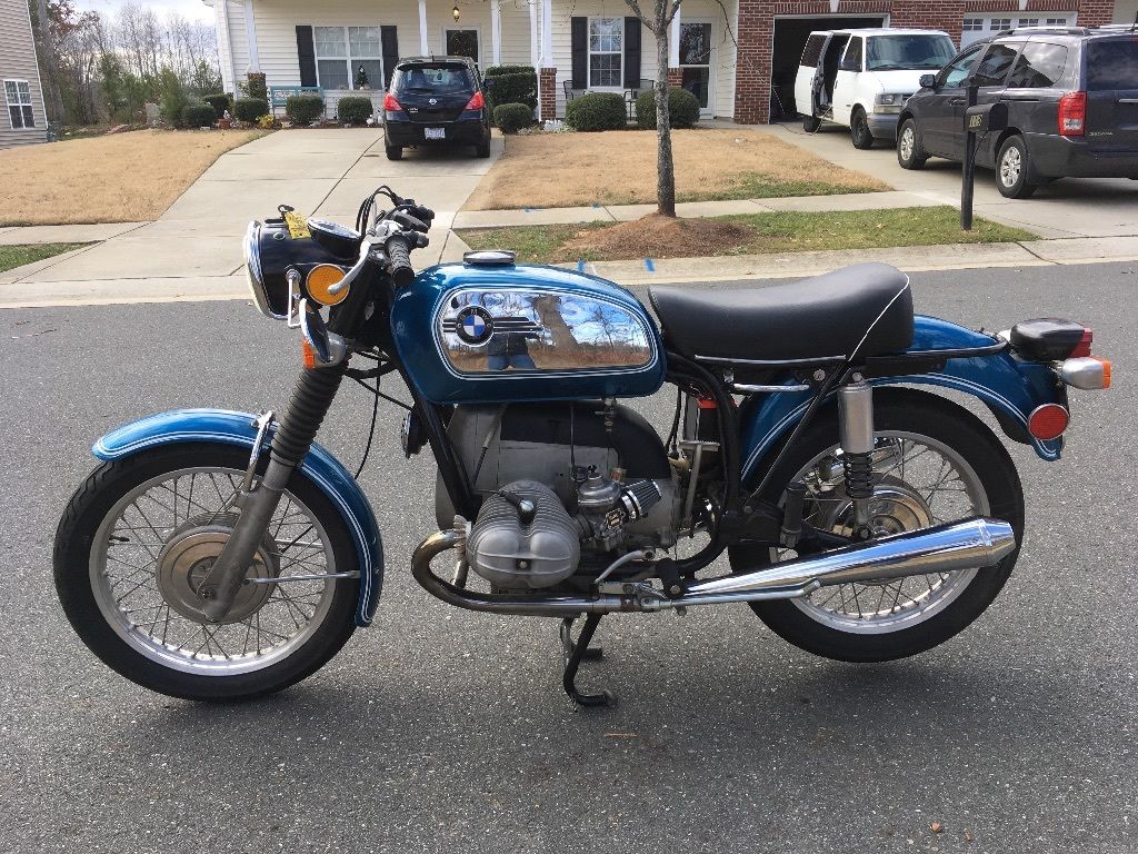

Post by Mottseng »
Hopefully the picture uploads. Here is a pic of my recent excitement.

They may offer other fitments. Three times brighter, uses a fraction of the power. But I have to tell you, that in my experience of airhead ownership (45 years), most "upgrades" are a mistake and will reduce functionality. BMW knew what they were doing. There are some exceptions. You may want to firm up the front forks, but many go to far, a lot of the fork springs available are to firm, and you loose the excellent ride BMW provides. There is nothing wrong with points and condenser ignition. You can bring a spare set and keep on going, where someone who has changed over to an electric box, will be stuck on the side of the road calling for a tow. IMO you are best off using the bike as intended. I've seen many thousands spent on airheads, where someone has attempted to make the old shafty a sport bike. Any $1500. sport bike from the last twenty years will leave the now devalued airhead (due to non original modifications) in the dust. IMO use them as designed with some personal adjustments.

Also, DO NOT cut either of the fenders!
Hide them away somewhere and use aftermarket for your project.
The best engine improvement you can make is to make sure the stock engine is performing at it's best. You will have a sweet ride.
