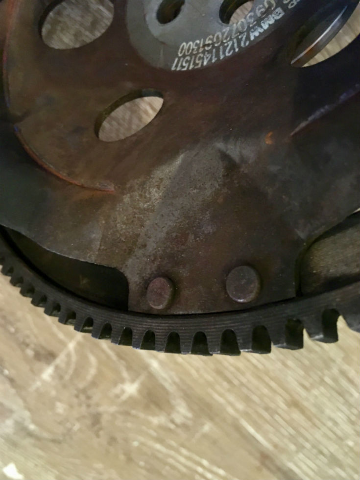

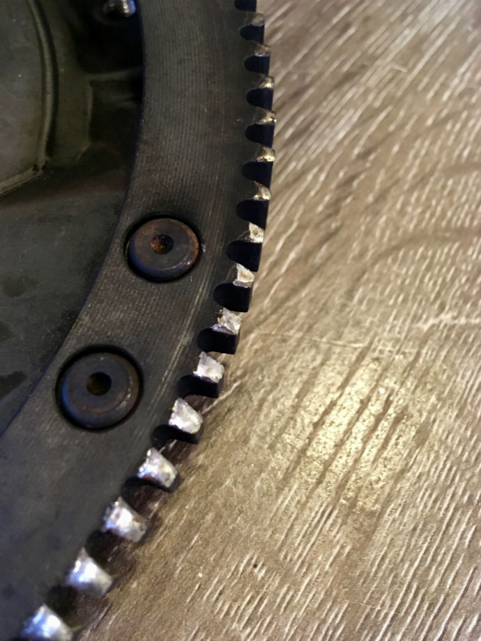

Hey all,
I whip back I bought a 1986 BMW R80RT, Ever since I bought it it intermittently makes a horrible noise whilst starting. Decided I should do something about it and looks like the Bendix drive on the stater is not engaging with some of the teeth on the starter ring. Looking at the ring, typically the teeth are worn fairly badly in one spot. Assumedly due to the compression of the engine frequently stopping the ring in the same place.
Iv'e taken the Clutch carrier out with ring gear attached and what I wanting to know is if it is possible to remove the starer ring and effectively flip it over so the the starter engaes with with "new" teeth on the other side. Looking at it it looks like the clutch carrier is fixed to the ring via 6 pins and has been heated shrunk in place....
Anyone aware if the pins are able to be removed from the starter ring?
Any help appreciated.
Thanks!

The ring gear teeth have a bevelled lead in. The bevel can look like wear when it isn't. Of course you may have wear on top of that.....
If you were to swap the ring gear ass about, you'd need to recreate the bevels.
I'd find a replacement.
Got a good pic?

Thanks good to know., pics should be attached to original post? looks like if I can't flip it next cheapest option is to have it rebuilt by a restoration place. I think the weld up new tips and reshape.
Can anyone see the pics?

What am I doing asking for pics!!
Yes, definitely worn. So it's a replacement ring gear and a new bendix to complete.
Seriously, those ring gears should be available from someone in NZ.
Perhaps ask on ADV rider forum, there are a few from NZ there, or 'Facebook airheads down under' plenty there too.
Less than 50 bucks should get you one in good shape.

Perfect thanks will ask around! You positive about the bevel on the one side of starter ring gear teeth?
Having a look at the ring I can't see any markings to denote orientation and close inspection of non damaged teeth doesn't seem to have any bevel on? I can't quite tell but it feels like the teeth may have some angle on them as the sit on the ring gear, very slight if its there...
