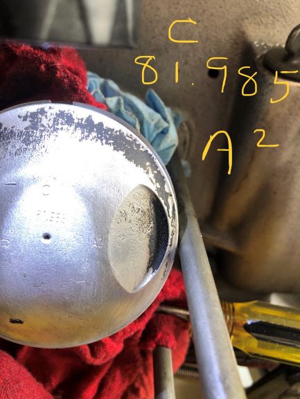

Hey gents - the left exhaust has been burning smoke (oil) usually at start up and occasionally at throttle. I finally decided to pull the heads, piston/rings and barrel. After cleaning and inspecting the head over (valve guides, seats, valves, etc.) Most was in order. I ordered a few parts- springs and cam followers (very slight wear), but nothing major overall. Pulling the barrel was a different story. The piston looks and rings (aftermarket) look intact, but there is a scratch I can see and feel with my fingertip in the bore, and it is at the 6 o'clock position- I am pretty sure this is the culprit.
I need some input, in layman's terms please, in how to handle this in a economical way. Piston sizes, rings and sleeves are an area I don't quite know, especially if re-boring is involved, and I don't have the tools to do so anyway. I understand the concept, how they work and install, but not how to fix and replace if work is done on them.
So here are my options and questions:
1) Do I hone or re-bore and put oversize rings and/or pistons? How do I know if just rings or both are needed? How do know what size piston/rings to get after it is machined?
2) I haven't pulled the right side yet- assuming it is in good order, do I have to do both sides regardless? Or just the left one? I was told I should do both.
3) Having both re-bored out the same is almost the same as upgrading to the 1,000 cc. I do prefer to keep it as is, don't really need more HP. I like how it rides and is smooth, which I read would change with this upgrade.
If repair is the way to go, does anyone know a good machine shop somewhere in the Raleigh , NC area? Bombars has moved, and I believe he sourced it out anyway. Boxer2valve is in Hendersonville, NC - 4 hrs away, so if there are any competent shops closer would be most ideal.
Trying to decide the best way to fix this. Your input does not have to technical or overly detailed, just brief comments of piston/rings sizing issues, advantages/disadvantages or anything else that may be useful. Below are some pics I took. I darkened the scratch area so it can be seen more clearly, but it is a photo edit and looks worse than to the naked eyeball viewing it. Thanks guys...

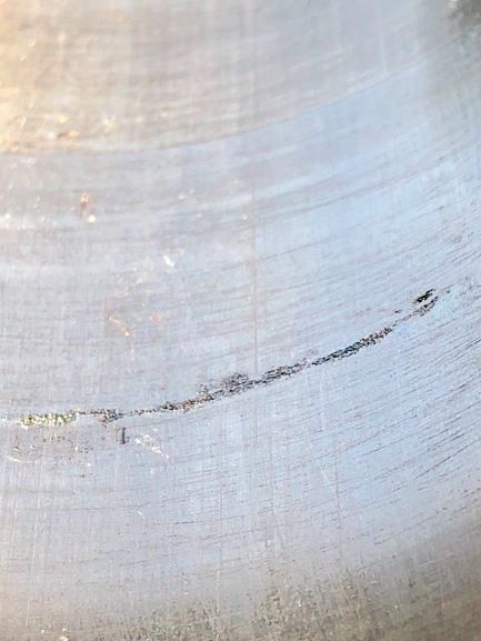

Thanks Kurt - I have a 83mm silicon carbide flex cylinder hone. I think the grit is 240,for the end of my drill. I am familiar with how to use. I think I understand how to measure the gaps with a feeler gauge in the rings at different points per snowbum - but not sure what those specs should be though. To measure the ring lands, do you insert a feeler gauge in between the side of the rings and the piston wall of the groove? I don't know what spec that should be either.
The bike has only 31,000 original miles on it. The PO put aftermarket rings on it.
- IMG_4472 (Edited).JPG (41.48 KiB) Viewed 3107 times
Re: Bore or Hone Advice

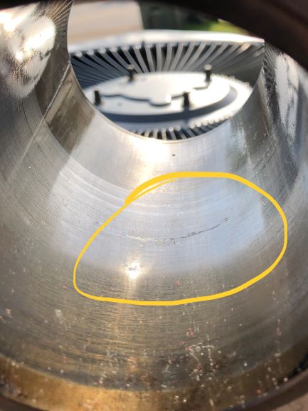

Another pic that was left out.
- IMG_4473 (Edited).JPG (37.04 KiB) Viewed 3107 times
- Posts: 1734
Wow, that scratch looks pretty bad, at least from the picture. Honing might not do it. Is that the right hone for an iron cylinder? That sounds like something for a Nikasil cylinder, which I assume you don't have.
Thanks Kurt. I was trying to be optimistic, but....
Well, I guess i just have to bite the bullet and re-bore. If anyone knows of someone who works on airheads for this in my area, let me know. Thanks!

Bore it! I did the same on Ernst, and it's worked out well. 17000+ miles since. The first oversize is .5mm or about .020 over. That scratch looks deep, though, like maybe the first OS wouldn't eliminate it.
Per robtg (retired ace Airhead machinist) go for .0015 skirt clearance on an iron bore Airhead.
