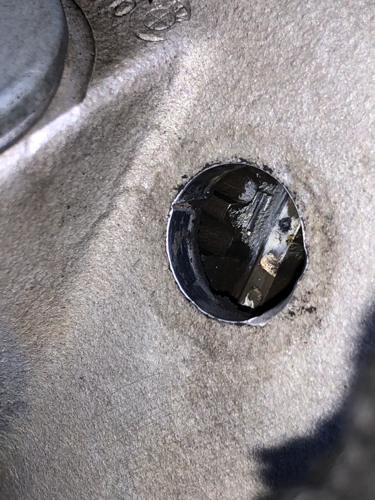

1) my "OT" mark does not look like any of the ones I've seen in videos or pictures. I move past the F mark, which is clearly visible through the hole, but rather than seeing "OT" through the opening in the same place the "F" mark is, I only see a "T" written on the side of the gear next to the teeth (i.e., it isn't on the same surface as the "F" mark, it is 90 degrees to the side, which means I have to look more from the rear of the bike in order to see it). It doesn't say "OT," only "T". Is this still the correct mark? When I have it in place (there is a small hole punched next to the T on the surface that is visible when looking directly into the hole) there is a little wiggle at the valves. They both appear too tight.

1) You can find OT for yourself. Be sure you are looking at the end of the compression stroke. You will need to remove the spark plugs. Put a plastic straw or the like in the hole and watch the straw move out, stop moving for a bit, then back in as you rotate the engine. In the middle of those spots is OT on the compression stroke. See if that matches up with your "T".

thanks, Kurt. I did end up taking out the plugs, and that method helped to verify that T = OT on my bike. I used the 0.15mm/0.2mm spec. Hopefully it is all set now.

You probably have a lightened flywheel and the original OT mark was machined away. It was very kind of the machinist to remark the flywheel. They don't always do that.
