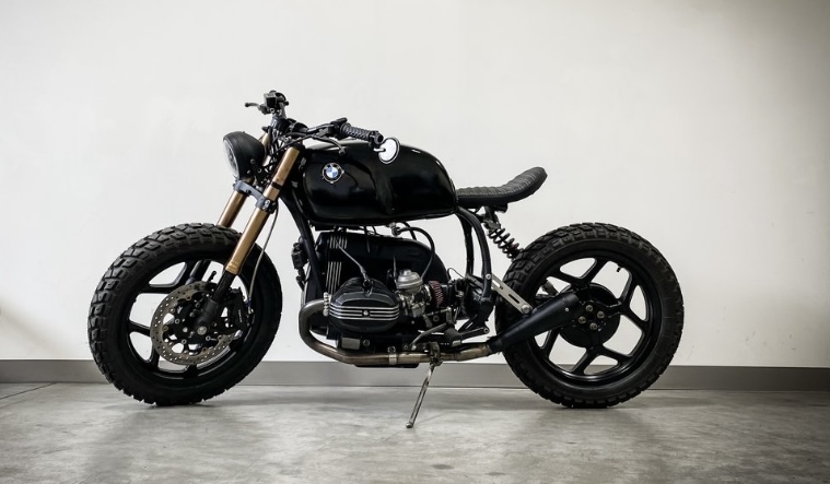

Hey guys, I am finishing up a 1991 R100 and hung up on the final part..This bike is putting me through the ringer here. I've tuned a good handful of these awesome machines and this one isn't wanting to play nice.
Heres the deal...it runs beautifully up until high speeds. At 60-65mph it starts to cut out/sputter until I let off the throttle a bit and drop speed then it is back to normal.
Here is whats been done:
Full carb rebuild, new bing carb kit and diaphragms. DNA pod filters, mac 2-1 exhaust. Fuel level set to 24mm, jet needle clip set on lowest point. I tried a 145, 150 and 160 main jet. No difference really, actually the 145 runs the best. Plugs after a good hot run are pretty white still which would indicate a lean condition. Also has slight back fire at times when off throttle at speed.
I could get it up to 75mph and thought it was an ignition issue. It originally had an Accel two pole 3 ohm coil on it. I thought maybe it was doing some weird stuff so installed a new 3 ohm euromotoelectronic coil and new NGK wires.
Now I can only get it up to around 60-65. Ran better with all the old stuff. At first, I checked the float level and it was LOW like 12mm low. Raised it to 24mm as I have the 32mm carbs. Helped slightly but still cuts out. I pulled the inline filters, new fuel hose clean and clear tank. Carb sync good to go as well.
I tried opening the cap when the issue is present and no change. I really think it's still a fuel issue but running out of ideas now. I was surprised the 160 main jet made it run worse before replacing any of the parts it would ramp up to 75mph no issue then like others have mentioned it just sputters out, like the fuel is cut. I need to double check valve clearances but they where set to spec roughly 125 miles ago. I drilled a small hole in the bottom of the stock gas cap to and no change. Appears to be venting normally.
The bike starts, idles and runs absolutely flawless besides this damn issue. I did order some more thermal paste for the ICM. It appears to be lacking a healthy amount there. I also do have a full motogadget setup, stock ignition otherwise and I did see a thunder child diode board last time I was in there.
Tomorrow I may toss the old accell coil back in and just see what happens...
Thanks for anyone who has some comments/info. You all ROCK! ;)

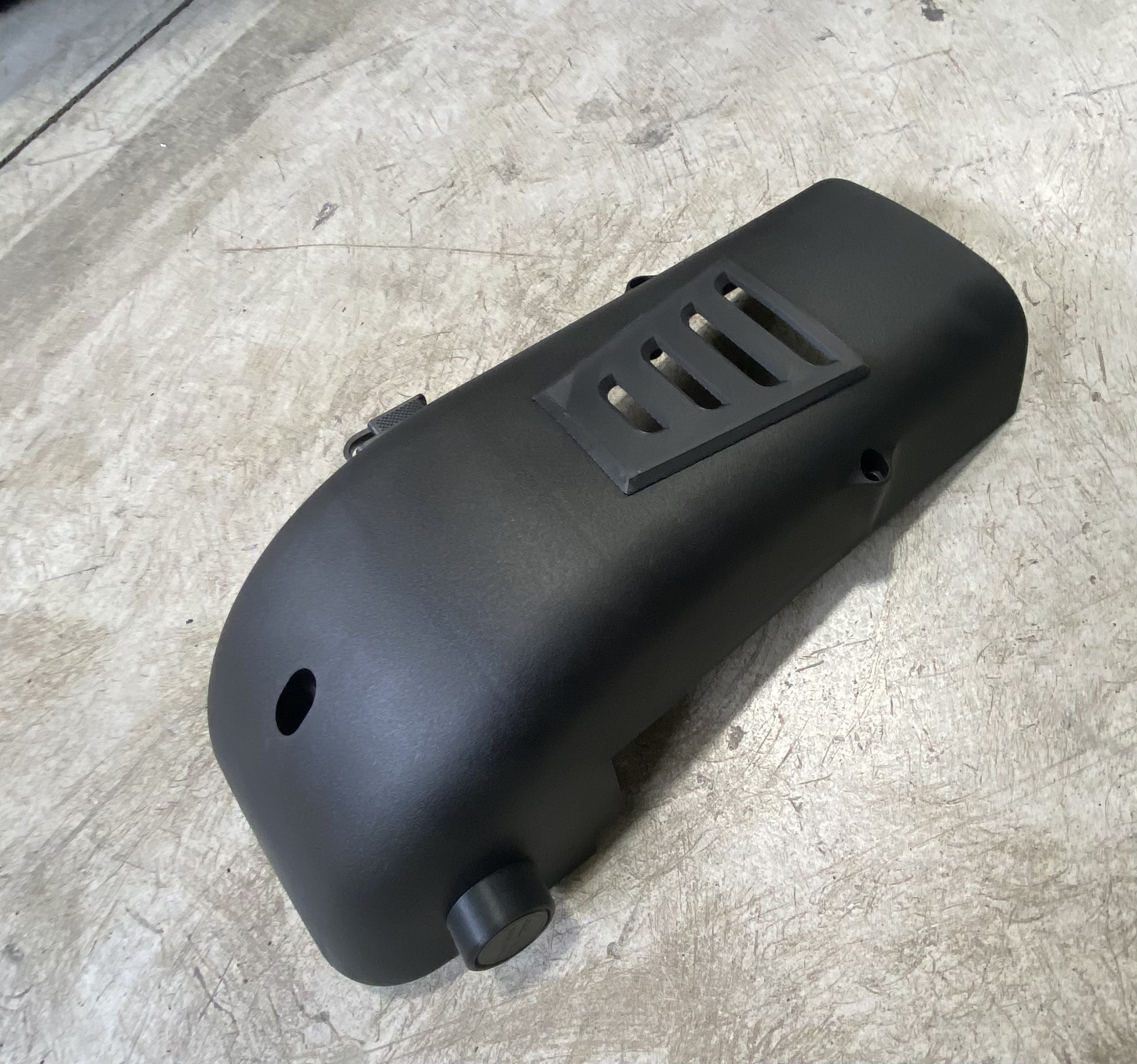

Crankcase breather has a filter on it. The new engine cover has a 3D printed air opening to allow the filter to vent to open air. I didn’t want it fully enclosed.
