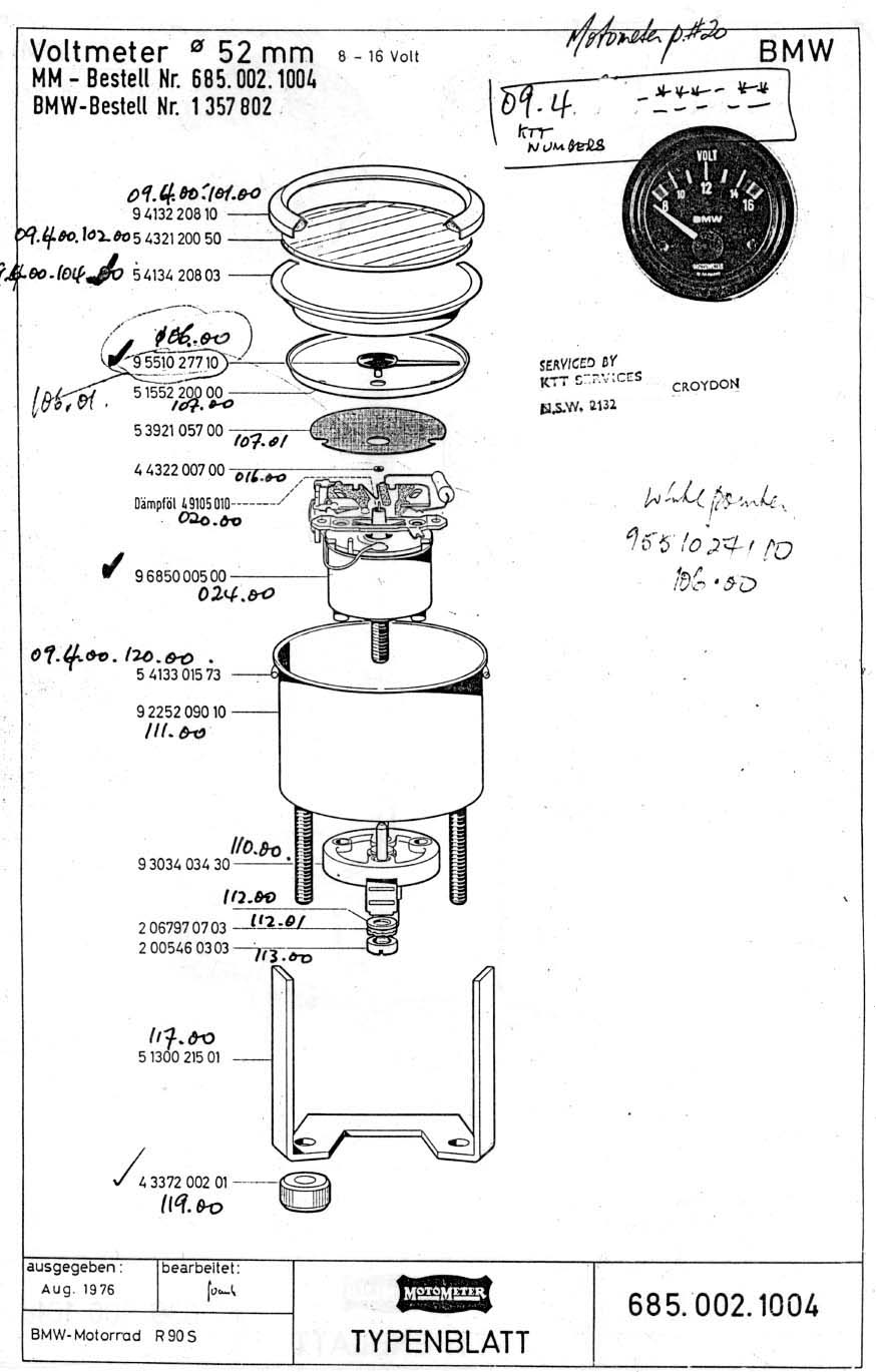

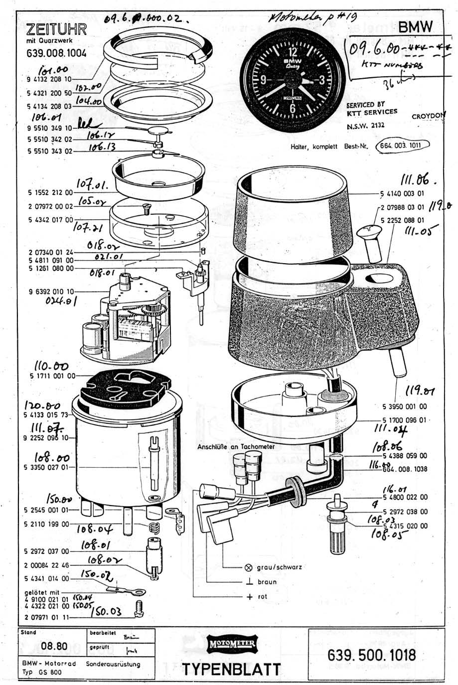

MikeO wrote: Sun Jul 03, 2022 5:30 pm... My clock must have some internal damage, not working when attached to power will replace with a VDO clock, when I get bored will open up the clock and see if I can repair it.
Reportedly the capacitors fail. I believe it's a relative simple job replacing these.
Tantalum 16V 100uf capacitor
The removal and reinstallation of the black bezel that holds the glass might not be so easy...but there is a way.
Pictorial...interestingly, the innards of the motometer in this has a vdo stamp. https://www.flickr.com/photos/getproduc ... 860750305/
Motometer quartz clock.jpg (190.46 KiB) Viewed 951 times
This is from a 1976 R90S, probably early mechanical.edited year... :? :roll:
Motometer clock.jpg (105.11 KiB) Viewed 954 times
http://velobanjogent.blogspot.com/searc ... eter+clock
from velobanjogent wrote:the dial configuration was a black background with green numerals with the pointer blades for speedometer,tachometer,clock and voltmeter coloured white...this was from 1978 onwards, prior to that, pre 1978, the dials were black background with white dial numerals and the speedometer/tachometer pointer blades were fluorescent red.
The clock movement prior to 1978 was not a quartz movement, but an impulse type.
A quartz clock can easily be identified when running as the pointer for the secondhand advances a second at a time and appears jerky in operation, whereas the impulse clock sweep secondhand smoothly sweeps around in operation
