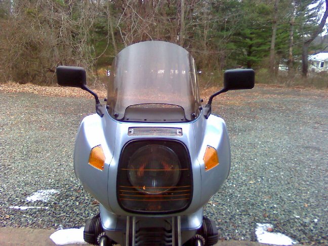

I bought a second pair of OEM mounts and drilled them out for a pair of NLA Napoleon mirrors.
Should have lubricated more while I was drilling as it heated the metal enough to spin in the plastic mount. Put a nut under it.
Done again, I'd due it more slowly with oil cooling. Then tap it with the appropriate threads.

Agree that's well worth looking at. These mirrors were also fitted to 'RT models and the heads will bolt right up to the existing 'RS mounts. They really do make a difference (although they're still not perfect). Ironically, the original 'RS head work well on the 'RT so I now have 'RT heads on the 'RS and 'RS heads on the 'RT.
