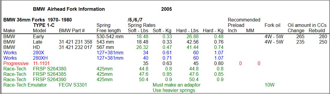

i don't think thick oil would cause lack of sag unless it was treacle.
If this is a previous owners doing, you might be suffering from the syndrome that the universal cure for all fork ailments is to put in stronger springs or preload them, however misguided that can sometimes be.
I can't remember where this came from so I can't credit it, but it was a good source. It might help you identify what you have once you get them out. If all else fails it's possible to calculate the spring rates from the spring dimensions and that could then be compared to stock springs. If it comes to that I can do the calculation for you.

Re: R80/7 Front Suspension Sag
Sag is all on the spring and the preload. Oil (all other things equal) only changes how long (time) it takes to get to the sag.
One note--if the oil level is too high, the air space above the oil becomes a highly progressive spring. See if loosening the caps at the top of the fork legs gets you a different sag result. Don't bounce on it with the caps loose as the fork legs will spray some oil out.

Hi Barry, thanks I am thinking more in line with you and need to look at the springs themselves as being the issue and maybe the preload, I have no springs to compare them with and if am going to replace them maybe there is better option to go along with the standard damper rods, any suggestions please. Note NZ roads are very bumpy even Henry Cole commented on how bumpy the roads are here, my F800gs with its suspension glides over them.
As for the packers on the top of the springs anyone know what length these should be?
