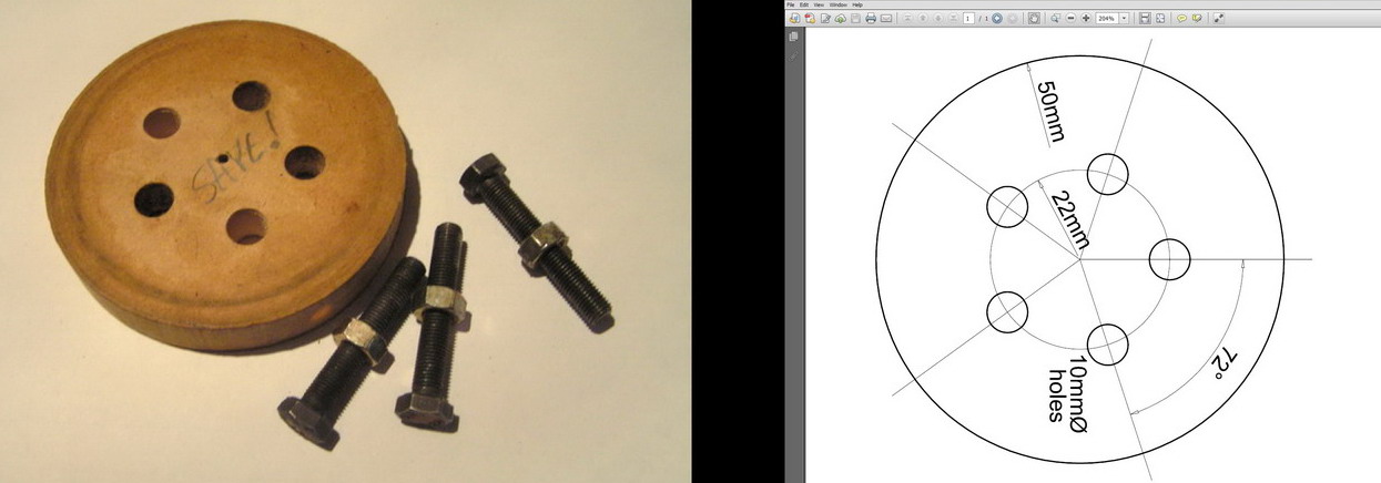

Phil, here's a simple tool that will pull the RMS to its rightful place:

Airbear wrote: Tue Feb 07, 2023 4:57 pm Phil, here's a simple tool that will pull the RMS to its rightful place:
Thanks Charlie, how thick did you make it?
