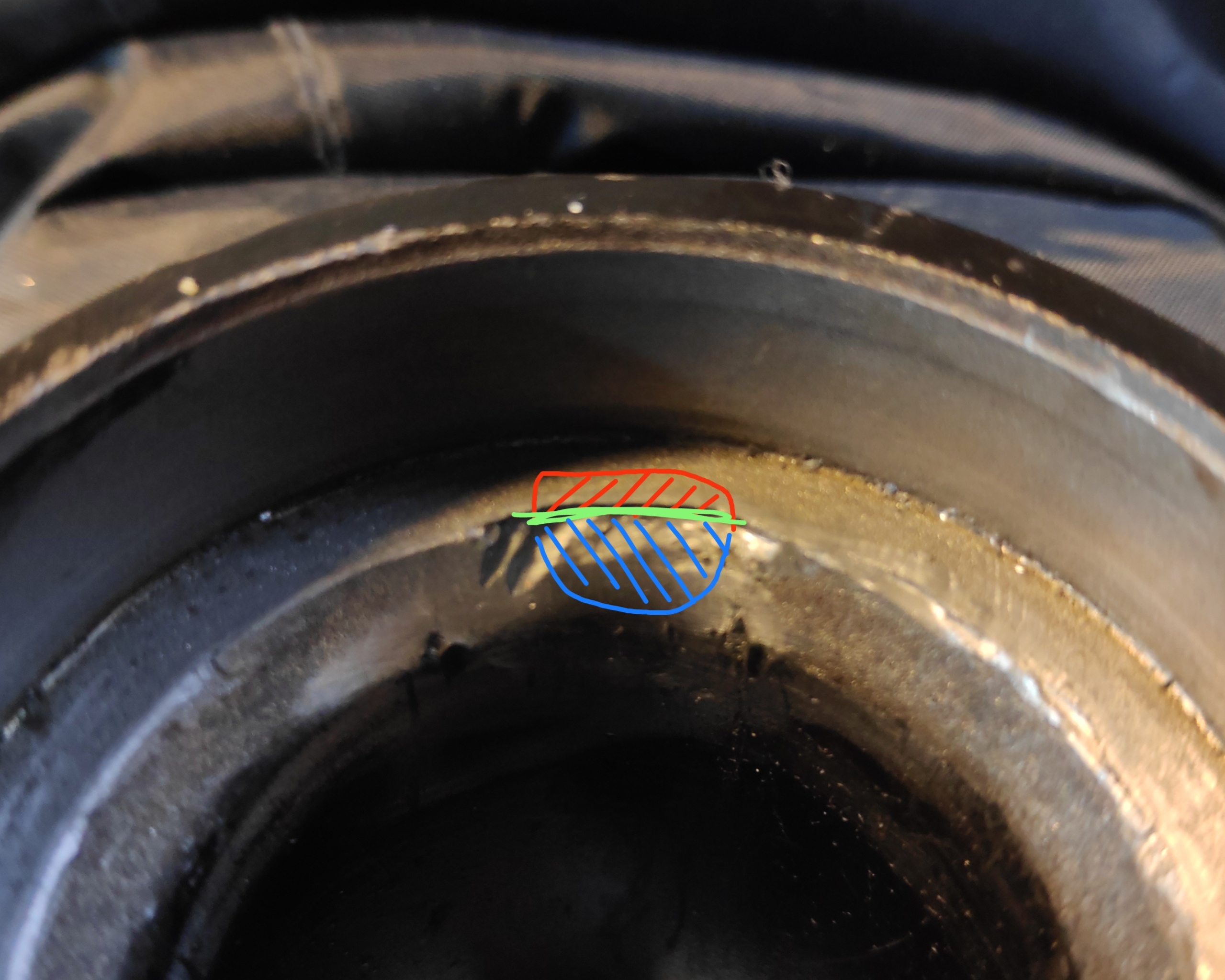

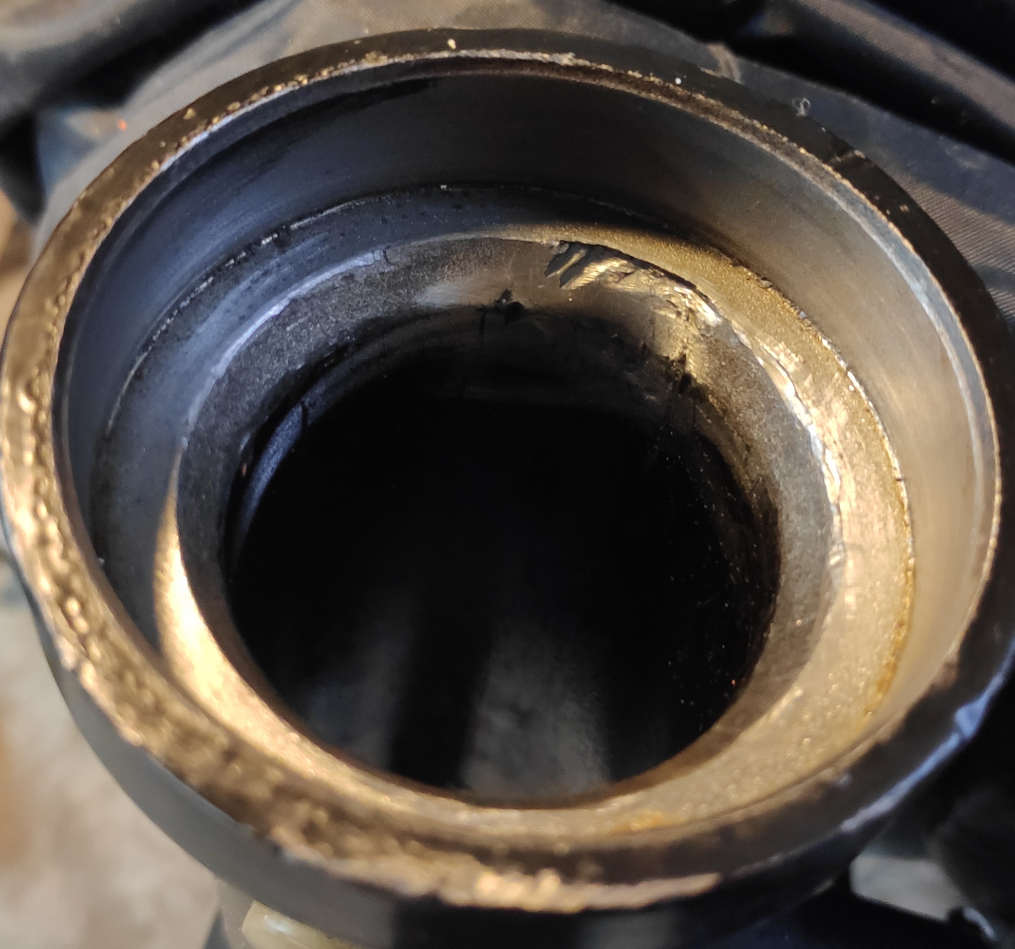

Tried with their slightly curved steel bars shaped like chisels beating from underneath the rings, but there is no space or slot to place the tool in and beat with the hammer so the result is this:
now I have to lower all the metal burrs that I raised by tapping on the inner edge...
the question is:
Do you think it would be useful to create two slots for a future disassembly?
like this

pioppiny_81 wrote: Sat Feb 11, 2023 11:12 am Do you think it would be useful to create two slots for a future disassembly?
whats your life expectancy?
They should be good for about half a million miles if you keep them well lubed and correctly adjusted.

There is a simple trick to get the head ourer bearings out (and swing arm bearings... any taper roller bearings really). Simply use a mig welder and run a bead of weld round the bearing face. The bearing will the be loose in the housing so that it can be removed with the minimum of persuasion. Often it will just lift out. I've done it numerous times and it always works well. No damage to the housing or modifications.

Rob Frankham wrote: Sun Feb 12, 2023 5:01 am Simply use a mig welder and run a bead of weld round the bearing face. The bearing will the be loose in the housing
great advice Rob, I'll keep it in mind for next time, tanks
