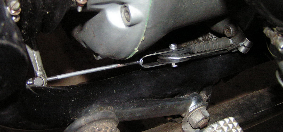

Phil, there are work-around solutions. The UTMC is a horrible thing - squeezing the brake lever feels like trying to crush a lump of wood with little result. A bar mounted 13mm MC from a later model or aftermarket makes a huge difference to braking force and the engagement is closer to the grip.
The clutches on the pre-81 bikes are pretty brutal too. A lot of people are using a pulley setup to halve the effort and increase the engagement zone. Here's mine, made in an afternoon after seeing Rob Frankham's version posted on the BM Bikes forum:
NEWCLUTCH S.jpg (179.94 KiB) Viewed 6401 times
I can squeeze the clutch lever between thumb and forefinger (I had already installed the lighter clutch diaphragm spring). Makes me grin every time I use it. If you don't have the means or inclination to make one there's a bloke over on ADVrider selling them for US$80 (ouch).

jackonz was concerned about the reach to the lever. The EZClutch system you show reduces the forces, but doesn't address the reach issue.
Thanks for the info, I still have the strength to operate both the front brake and clutch its just the reach to them, besides the clutch is far easier than what I had with my old Norton Commando.
As for the front Master cylinder I searched high and low for a used one as the price for new is horrendous given the low value of the NZ$, so I did a full rebuild on the original and it seems to work as intended but adjusting the cable to make it easier to reach means the clearance setting at the Master Cylinder is out of whack, so I will keep searching.
