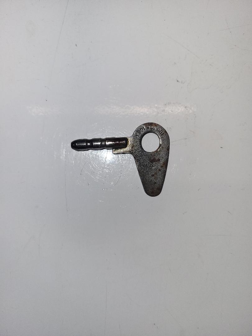

Heres the key.
Thanks,Tony
Heres the key.
Thanks,Tony
- bmwkey.jpg (49.07 KiB) Viewed 2138 times
- Posts: 1721
Re: 1972 R75/5 ignition key hard to push
Maybe someone can measure the diameter of their key shank. I have a /2 key...not sure if it's the same. Not sure why yours is so hard to push in. My /2 takes some force but I wiggle the key as I push down.

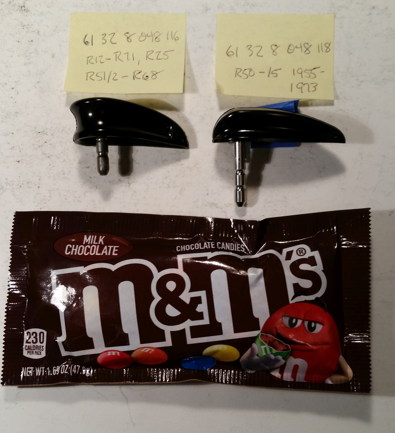

I finally got home and measured my R69S and R25/2 key...they're both 5mm across the widest part. I suspect that's not really the issue...it might have to with the shape of the cone which separates the contacts within the ignition. Not sure what to say either. Here's a picture of keys I bought...the one on the right is what I ended up buying for my R25/2...long story why I needed a new one.
Update: If the cone shape is the problem, one way to check is to use something like a real nail which has the same outside dimension...it will have a much steeper (more of a point??) cone which would slip in more easily. If that helps things, maybe consider using a grinder to change the shape of your current key?? Just thinking outside the box....
