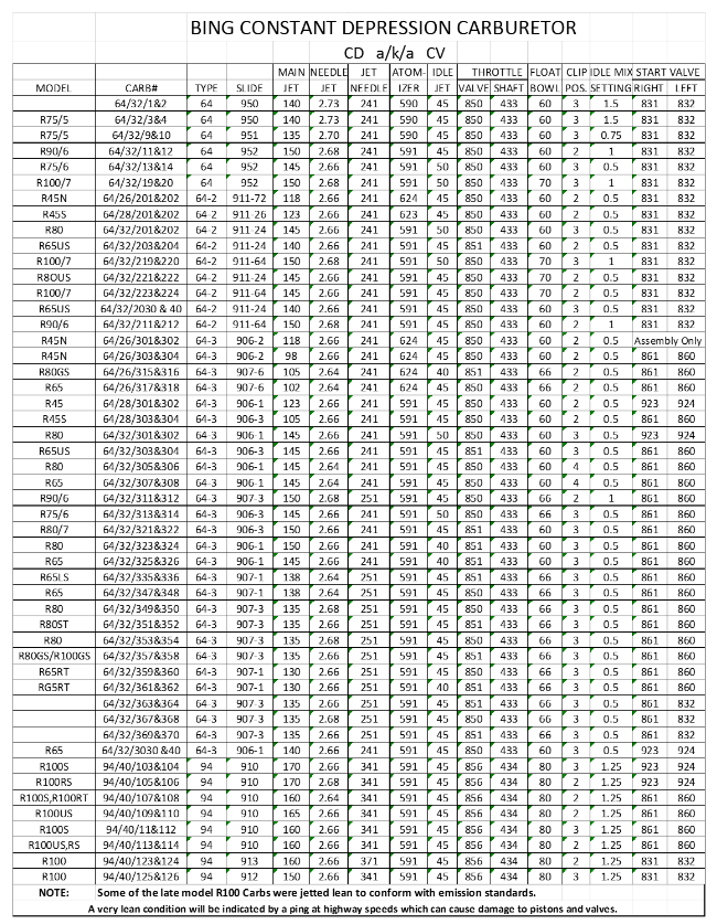

The bing chart says 0.5 turns out.
On a warm engine, set the mixture screws to their highest idle.
Ensure there is a little freeplay on the throttle cables...2mm usually plenty. Use the throttle adjust screws to set the idle.
