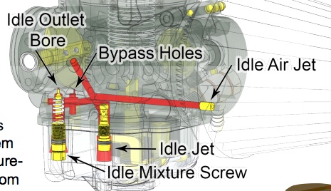

Turning the mixture screw in all the way should stall that cylinder. On your carbs the mixture screw controls the fuel, on some other types of carbs, the mixture screw controls the air. Either way, all the way in should cause a stall or something is amiss. Usually, when dealing with these old relics, it's often more time and cost efficient to totally disassemble the carbs, clean everything, and replace all the 'soft' parts. Good idea to throw in some new needles and needle jets while you're in there.
In the mean time...Remove the idle jet and mixture screw and assure yourself that all the 'red' passage-ways in the pic below 'connect'. If you shoot brake cleaner into the small hole (idle air jet) at the mouth of the carb while blocking the idle jet and mixture screw holes, you should see it come out of the by-pass holes. Faulty or worn o-rings on the idle jet, on the mixture screw and on the main jet, are cheap and easy to replace, but are often neglected. ditto for 'choke' gaskets.

Thanks again GSPD, that's exactly my plan. I am in a rush because there's a classic show ride this Sunday. It's much better so it will do for that and then on Monday it's full strip and new soft bits, needles, jets etc.
