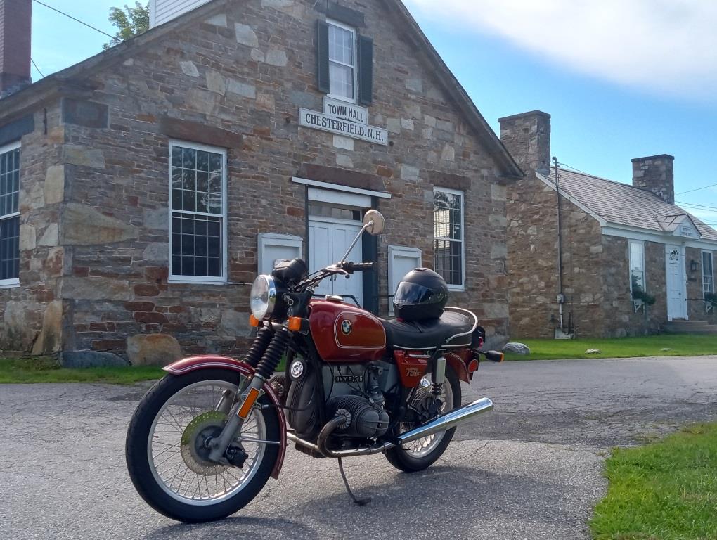

Airhead newbie here.... Just picked up a 1976 R75/6 survivor with about 38K original miles. This bike has won a couple Antique Motorcycle Club of America awards, and I'm thrilled to be its new steward. I'm busy working through through electrical gremlins in between rides (shocker...), but that's not the subject of this request.
The speedometer/odometer is wildly optimistic on this bike (about 25%), and I would like to hear folk's experiences. The Final Drive housing is stamped 33/11, and the "original" state of the bike makes me doubt that is incorrect. Any suggestions about wrong gears in the speedometer drive or in the actual speedo? Indicated 50mph = 40mph actual. Indicated 70mph = just over 55.
Thanks in advance for any advice!
