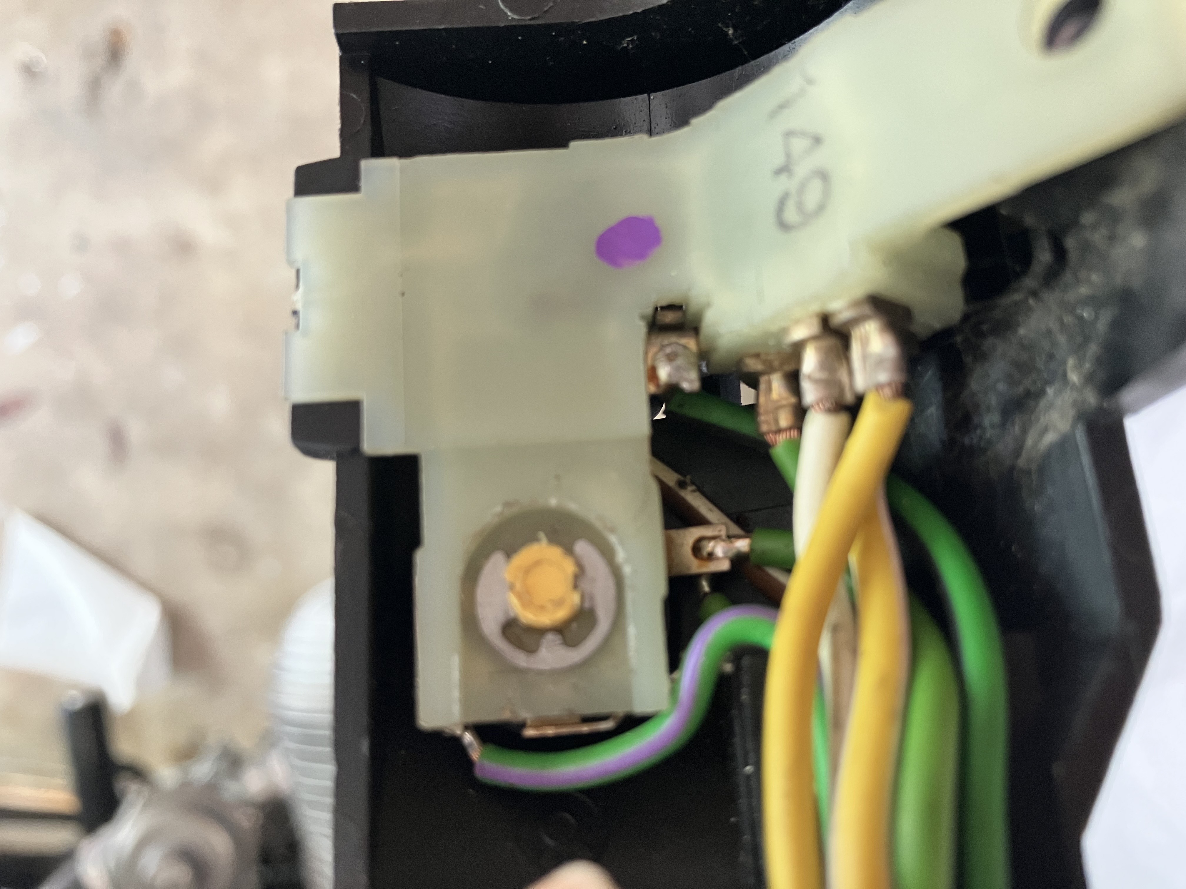

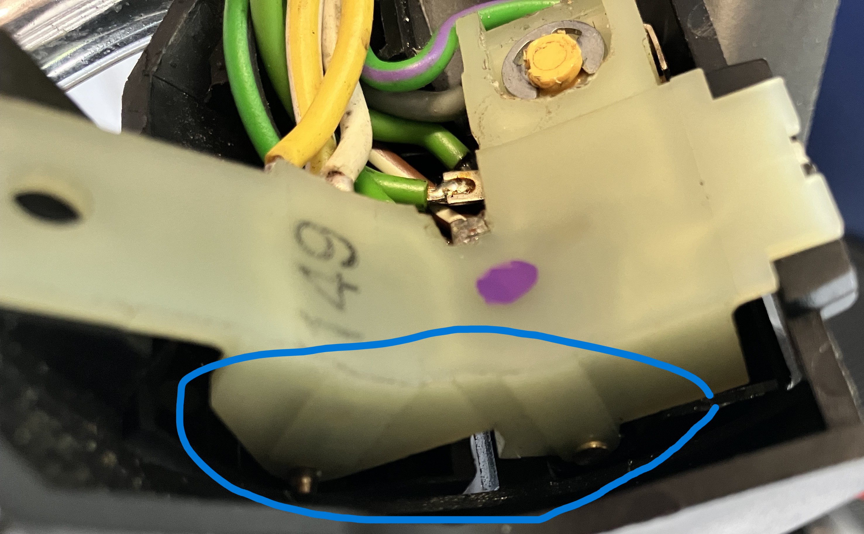

Hi fellow riders. the horn button on my 1976 R75/6 doesn't seem to complete connection when I push it. Horn tested good and I have 12v on the hot side of wire to horn and continuity on the ground wire (brown/white) all the way back to the switch. Has anyone tried to take this switch apart? A closeup of the switch shows what looks like a brass pin at the bottom holding the switch cluster in place. I removed the yellow light toggle but that did nothing to allow the rest of the switch to be removed from the housing. Any help is appreciated!
- brass pin holding switch in place?
- IMG_2766.jpeg (1.03 MiB) Viewed 32339 times
- switch
- IMG_2765.jpeg (1.87 MiB) Viewed 32339 times

To take the switch apart you have to remove the circlip and pull out the (yellow) switch, then pry the whole assembly out of the outer housing. I would suggest doing this on a white sheet, as there is a tiny spring and ball that will pop out with it.
Haven't done this in decades, but I recall it being quite simple as long as no small parts are lost
Jumping the brown/white wire to the brown wire should activate the horn.
The horn switch is just 2 simple contacts and rarely fails in a way that a squirt of contact cleaner won't fix it.
