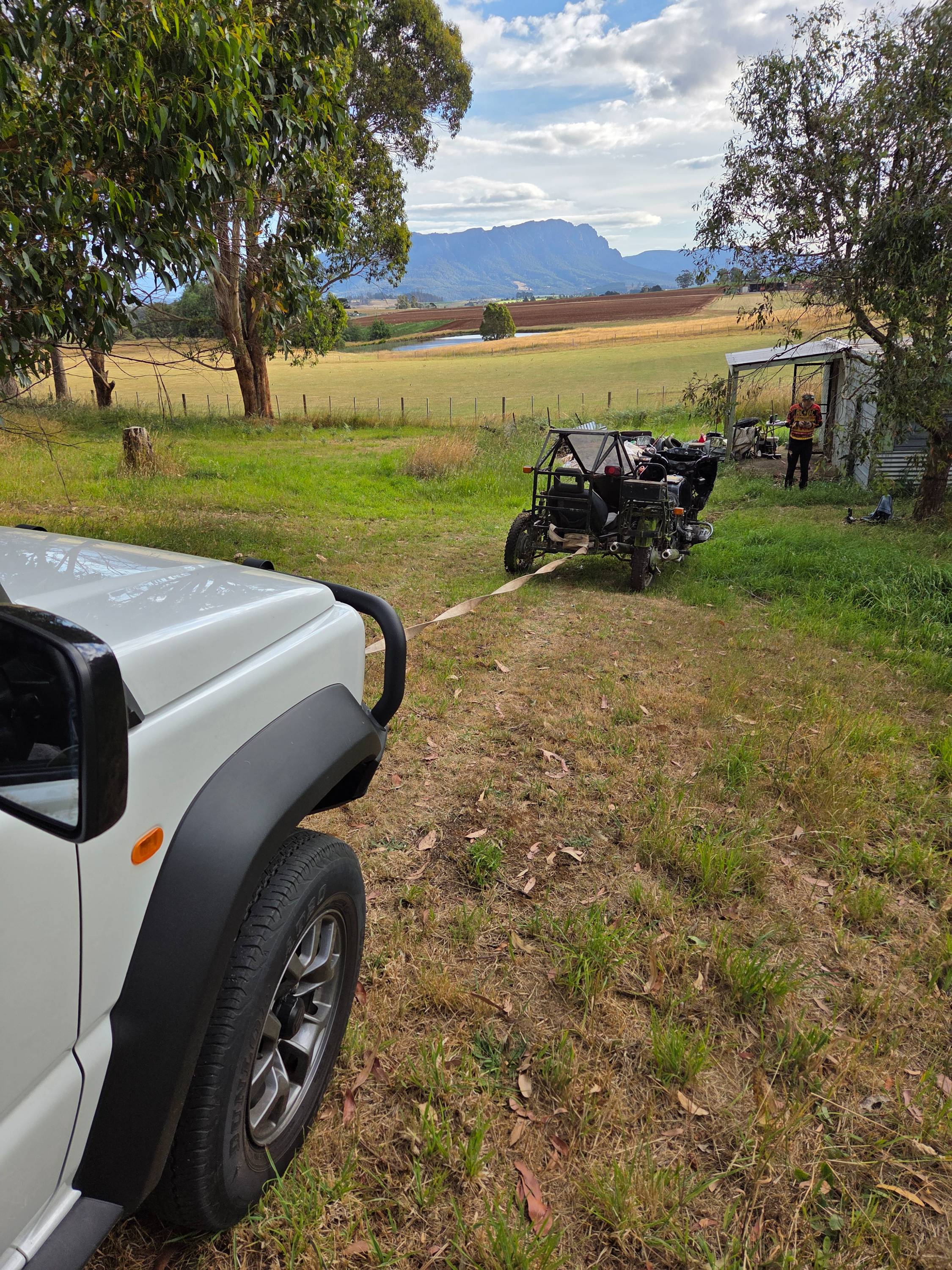

Managed to uncover everything......what a mess. Took some photos but they wont upload, as there is some sort of size restriction. I'll keep trying. Amazingly enough, after sitting for 10 years without moving at all, everything still seems to work. Wheels turned, gearbox runs through the gears, clutch feels fine...even the brakes worked properly. It was way too heavy to move up hill, so we put a tow rope on my son's 4WD and pulled it out back wards. On quick inspection, the fuel cap is rusted shut, so liberally doused in penetrative oil, and also sprayed the switchgear and fuel taps. The tyres were still fully inflated, surprisingly enough, so rolling back down the hill was no issue. The spark plugs came out very easily, so sprayed plenty of oil down the bores. I'll take the front cover off and turn the motor over by hand using a ratchet on the alternator bolt ( the same way i use to set the tappets). If its too tight, I'll have to put it in gear and rock it gently to free up any stuck rings etc. After that, I'll hook up the battery out of the Ute, and see if it spins over. I'll leave the plugs sitting on the fins to check for spark, and if it all works like it should, it looks like we might be in business. I'll keep persevering with the photos...

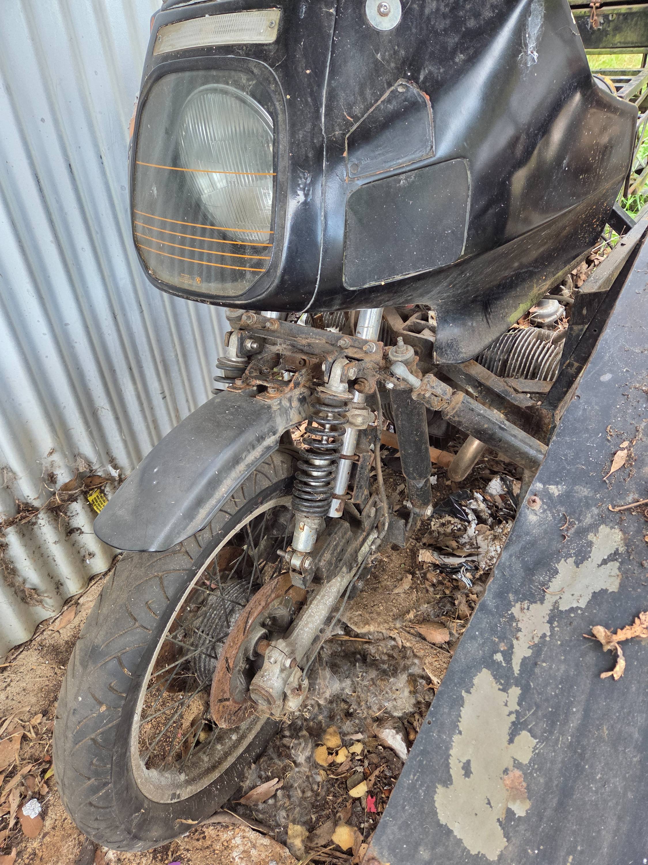

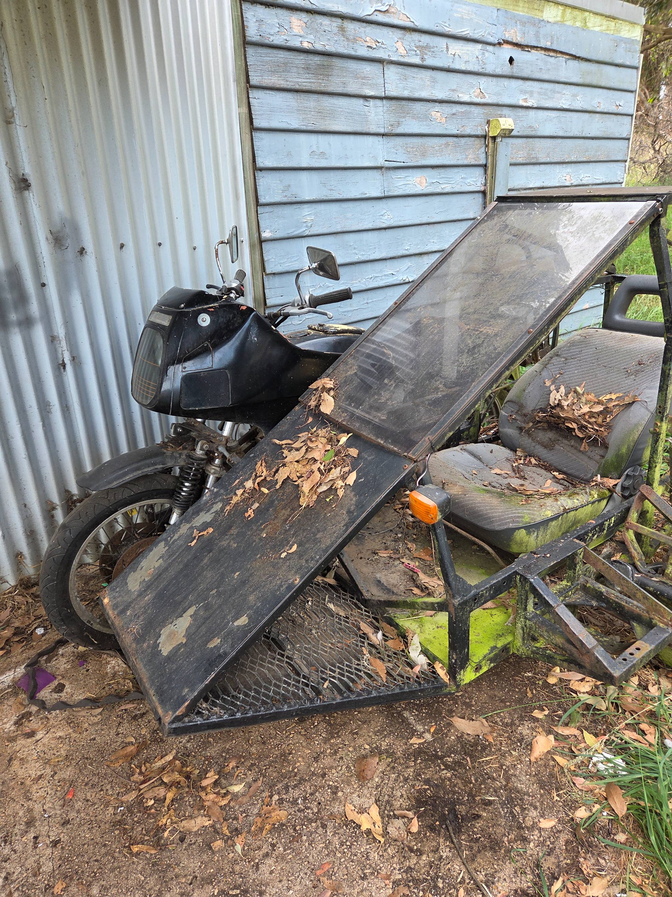

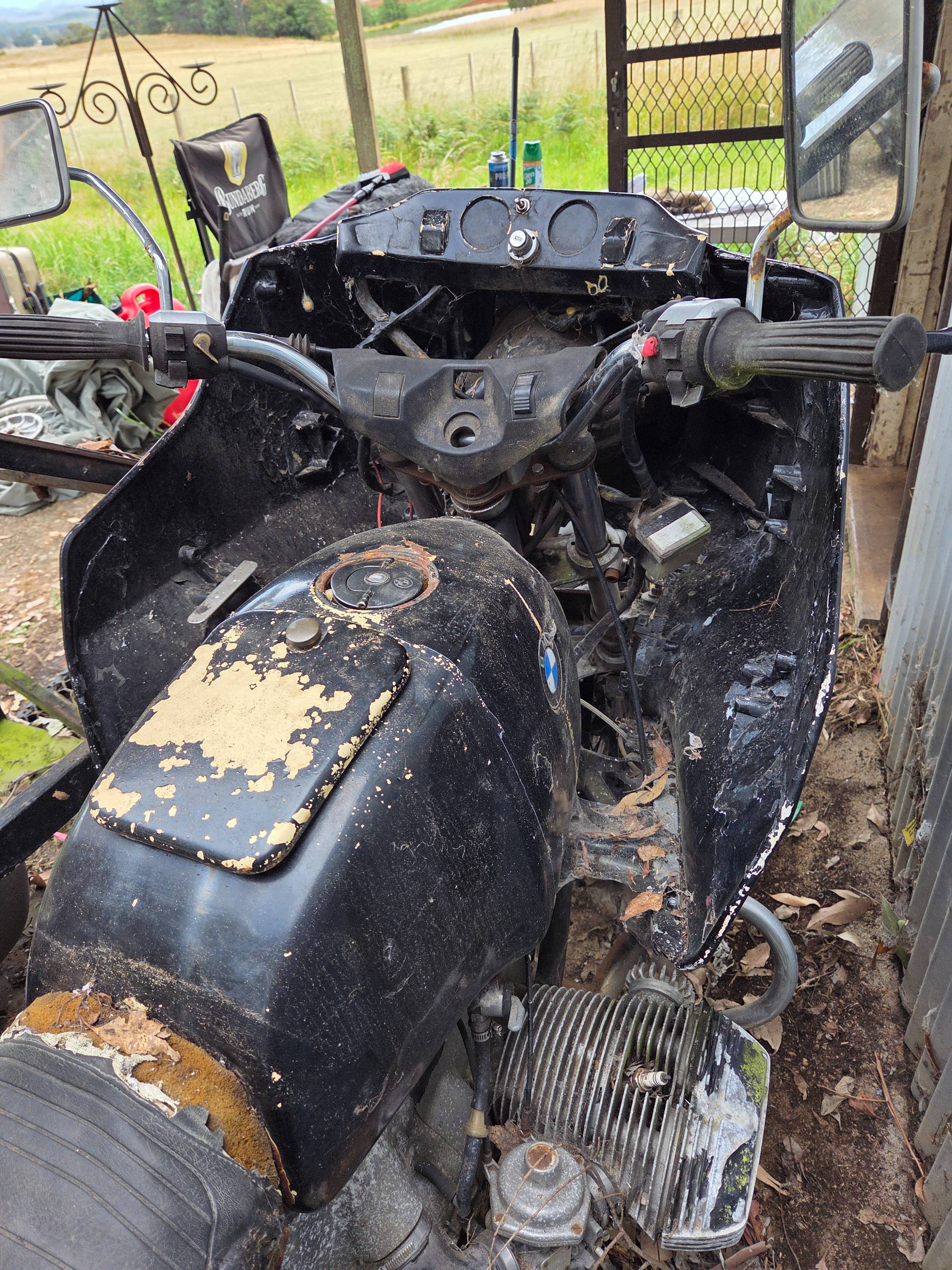

First attempt at taking photos....
- 1000003314.jpg (1 MiB) Viewed 11373 times
- 1000003320.jpg (1.21 MiB) Viewed 11373 times
- 1000003316.jpg (1.14 MiB) Viewed 11373 times

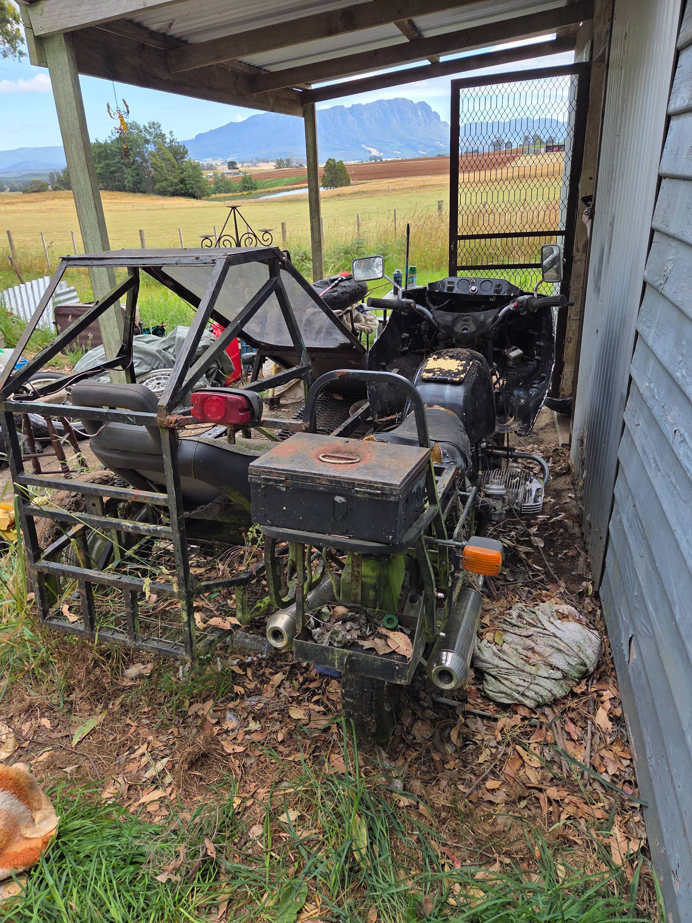

And a couple more to give you an idea of the sdecar set up
- 1000003315.jpg (1.18 MiB) Viewed 11373 times
- 1000003318.jpg (1.5 MiB) Viewed 11373 times
- 1000003313.jpg (1.29 MiB) Viewed 11373 times
Arado Ar234
- Posts: 17
- Joined: Wed Jan 14, 2026 10:06 pm
Re: 10 years later........
So, as you can see, it is rather modified, and somewhat mouldy after 10 Tasmanian winters, which last for 11 months of the year. I have a myriad of spares for this one, including 3 gearboxes, barrels, pistons, heads, carbies etc. Currently using the rear swing arm and final drive from a 75/7 as the sidecar wheel and suspension system. That rust welded fuel cap is the only thing that is really concerning me right now......can't apply heat obviously, although it would be spectacular to watch from a distance. Thinking about turning the tank upside down and pouring penetrating oil into it once I remove the fuel taps. If anyone has another idea, I'd be happy to hear it.
