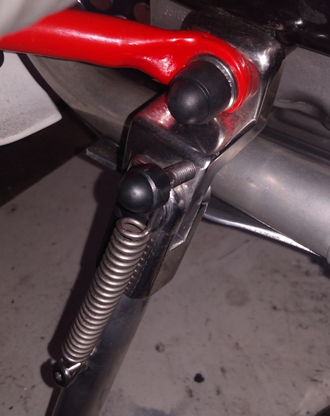

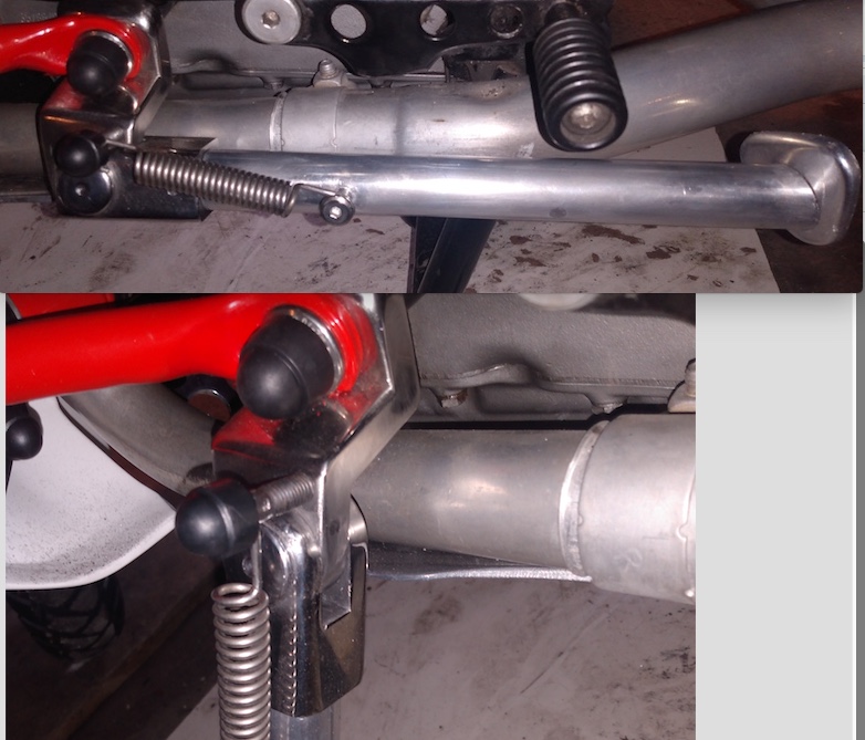

After decades of putting up with the stock side stand on my PD, I ended up designing and fabricating a proper unbreakable and unbendable one. The stock stand (and all the aftermarket ones presently available) will bend like a wet noodle if the the bike is tilted far enough over to lift it on its wheels, like when trying to pivot the bike around to get out of a tight spot.
All the parts are machined from aircraft stainless steel and the leg is a 1” solid aluminum bar. The spring is stock size (but stainless) and is strategically positioned so the stand stays down when initially deployed but the slightest nudge or vibration (like when starting the engine) will cause it to retract if unladen.
- stand .jpeg (148.25 KiB) Viewed 197 times
- Untitled.jpeg (80.06 KiB) Viewed 197 times

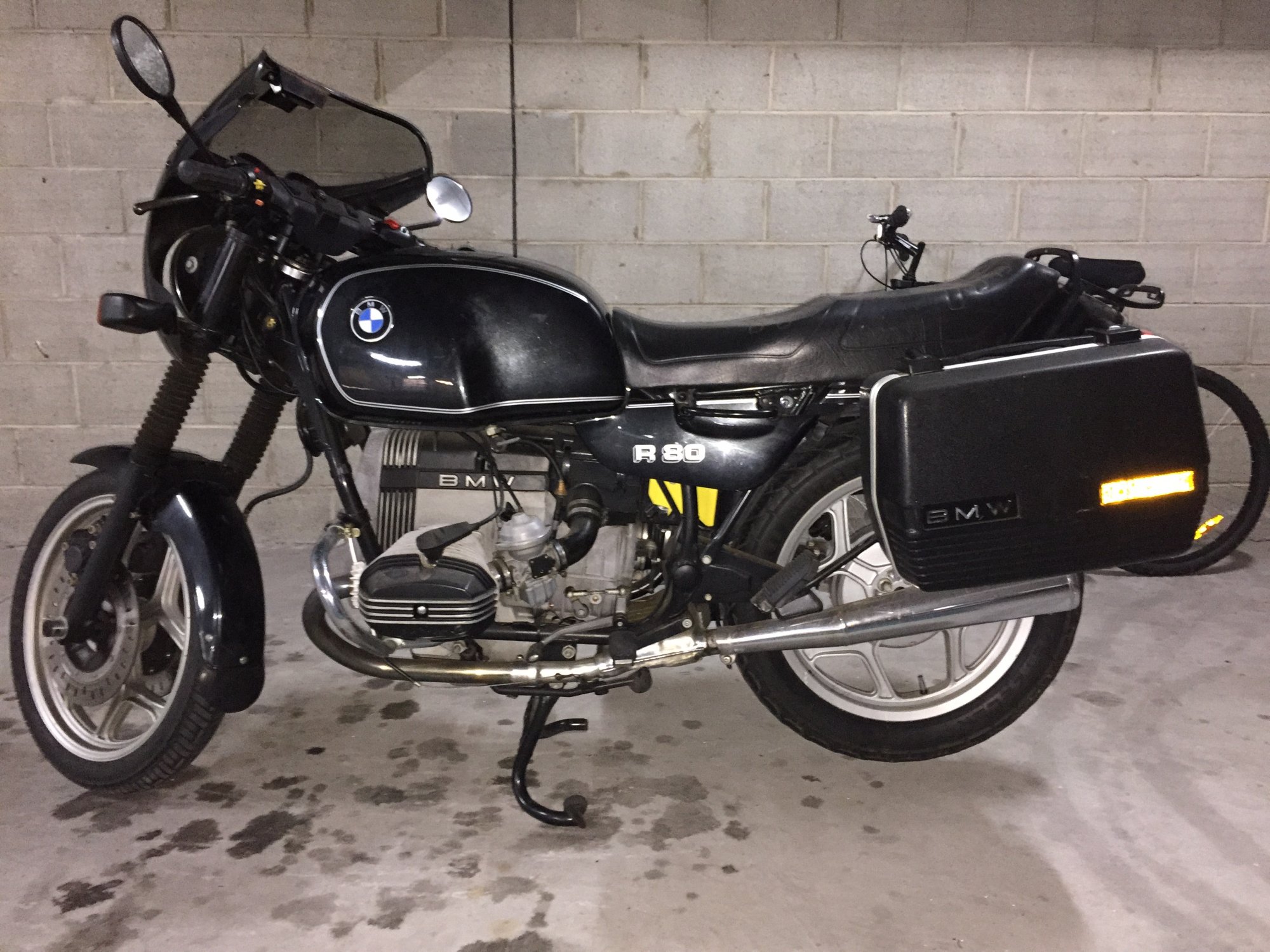

I’m getting to that age, and also too short in the leg to deploy the sidestand whilst on the bike, that I’m considering the hand deployed sidestand option spotted via internet!
- IMG_4018.jpeg (422.08 KiB) Viewed 183 times
- IMG_4019.jpeg (480.72 KiB) Viewed 183 times
