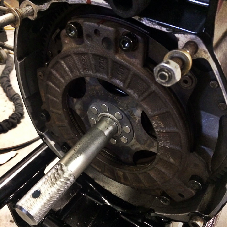

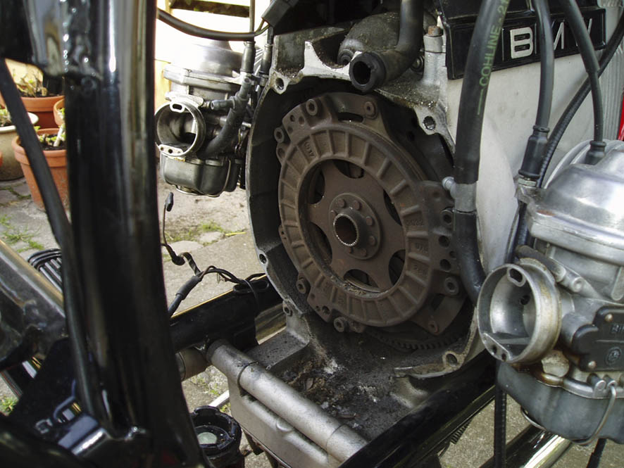

Fairly simple Q here however Im don't have a manual and wanting to reinstall clutch on R80 RT 1986. What is the correct orientation of the Slip Disc and what is the correct torque for clutch Bolts?
A couple of images I found are contradictory as attached. Any help appreciated

By orientation I mean which side faces out?
1986 BMW R80RT
Re: Clutch Plate / Slip Disc
Bottom pic is correct.
Aha! I could only see one image previously but now I see that you are referring to the friction disk.
The longer spigot points towards the gearbox. Here you go:

Excellent thanks guys, yeah i do have a manual however it is the BMW service manual and not as detailed. 20Nm torque on the Clutch bolts yeah?
