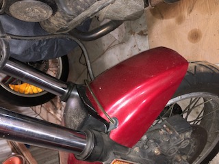

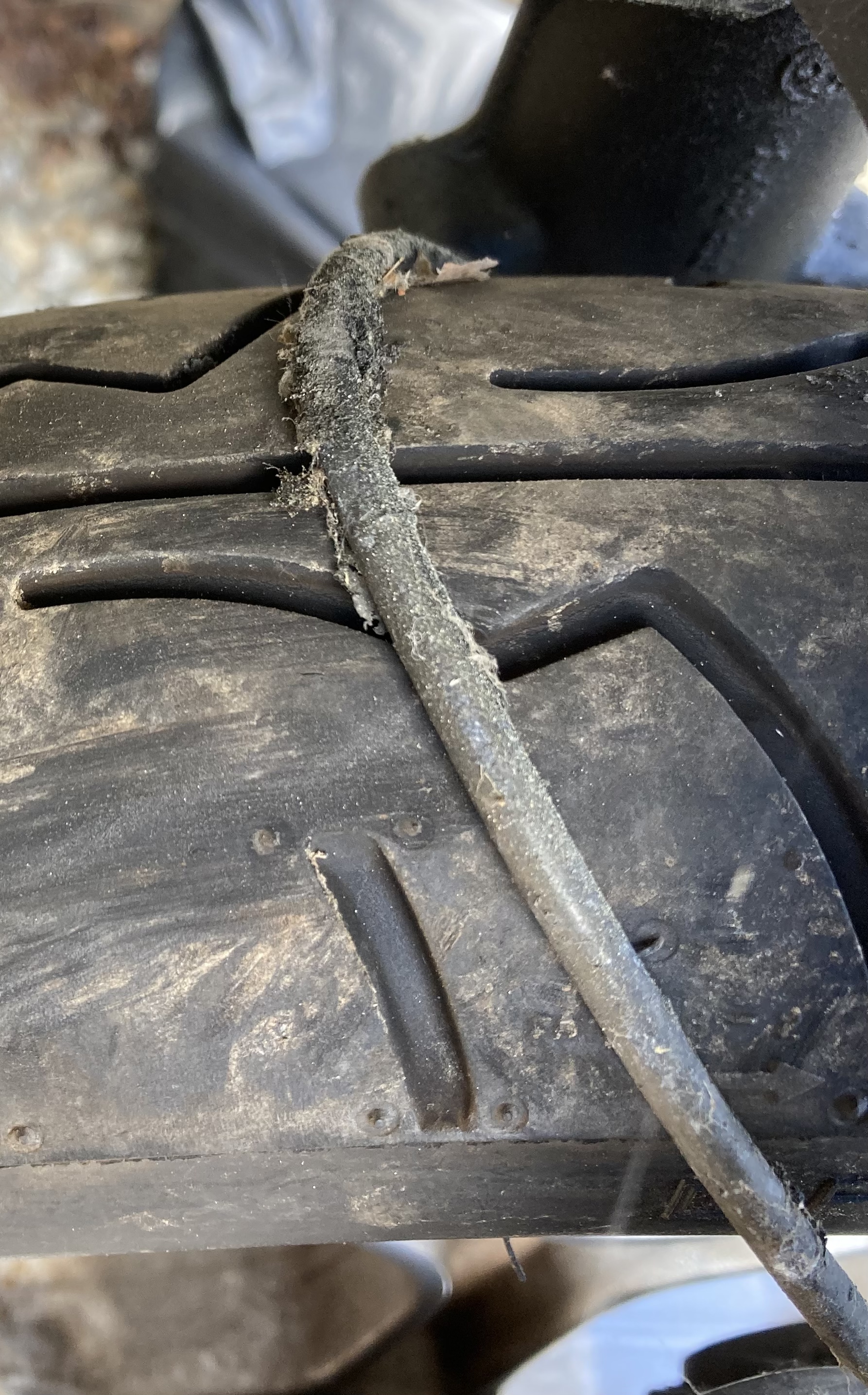

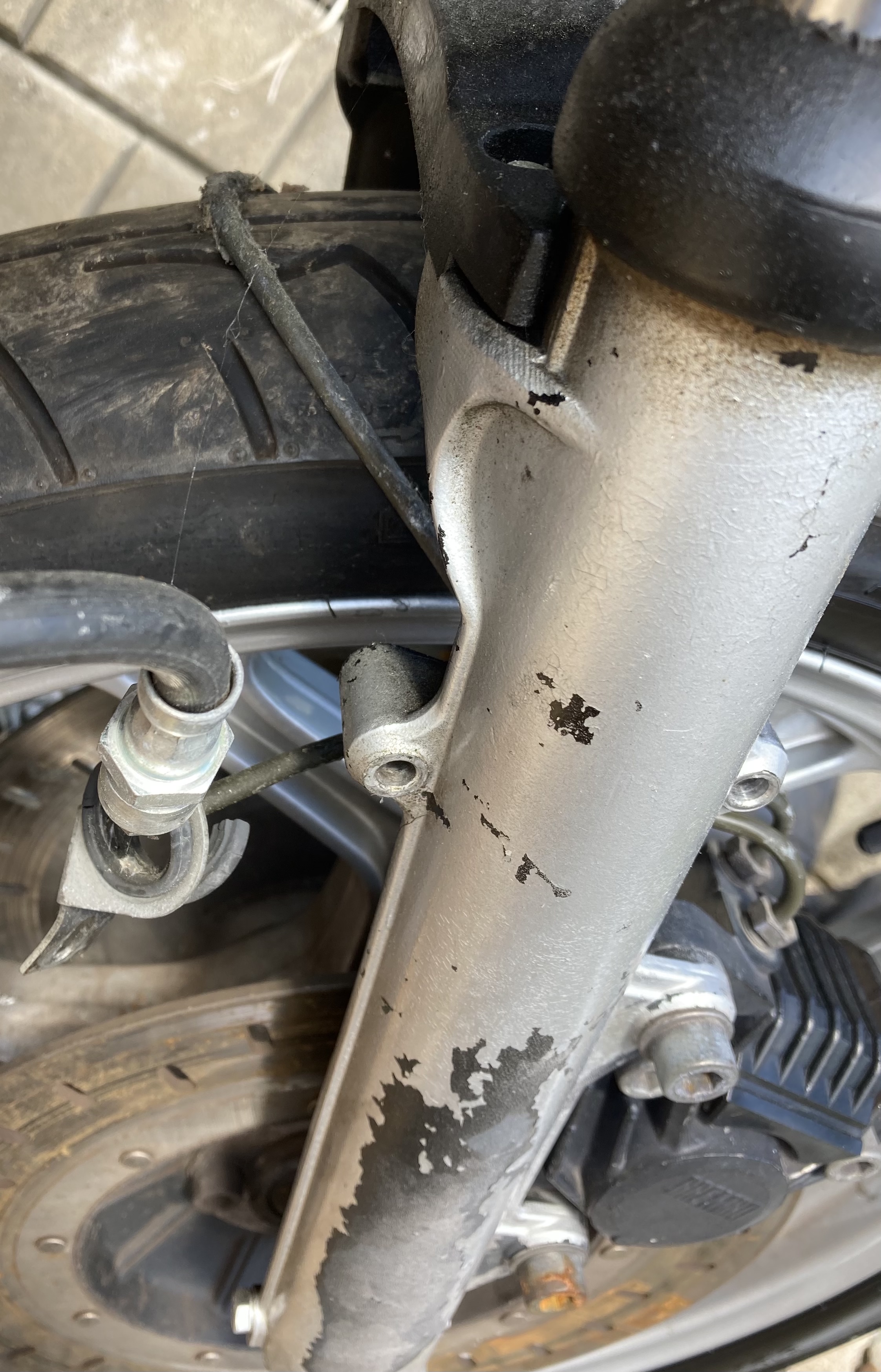

I was puzzeled that I couldn’t pull my bike backwards. I overhauled the calipers an was about to start changing the wheelbearings when I saw the real reason. The brake line was dragging on the front wheel! When going backwards the brake line would get more tension and would tighten up its grip on the tire.
I’m so glad it didn’t wear a hole in the pipe! I could have had an accident.

Yeah, I know! Quite shocked to find such a timebomb on my bike! I’m making new ones tomorrow and making sure to secure it properly.
Zombie Master wrote: Tue Jun 15, 2021 2:57 pm I guess you need to do a careful inspection of the entire machine.
Indeed! Bit by bit for safety and reliability. I guess this shows that if you find something unusual on your bike, examine it! Find out why!

Not really a fan of that 'over the wheel' brake line but there must have been an event that forced it down into contact with the tyre. The pipes are (should be) quite rigid and run close under the mudguard. My reservations have always been about damage from debris thrown up by the tyre, never seen the fault you have...

Rob Frankham wrote: Wed Jun 16, 2021 4:45 am Not really a fan of that 'over the wheel' brake line but there must have been an event that forced it down into contact with the tyre. The pipes are (should be) quite rigid and run close under the mudguard. My reservations have always been about damage from debris thrown up by the tyre, never seen the fault you have...
I believe you are right about road debris must be to blame.
