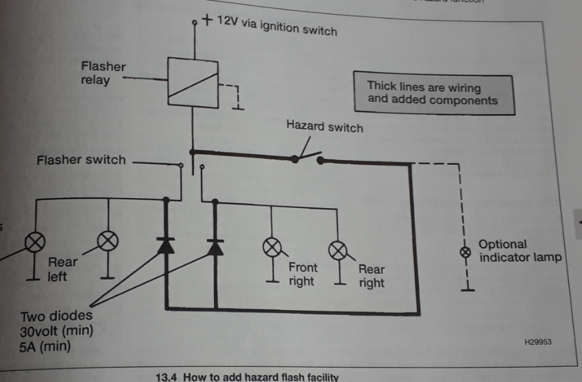

Evening Gents,
As per Robs request here is the schematic for the mod re hazards. its from the Haynes Electrical tech manual.
Hazard option.PNG (548.13 KiB) Viewed 1284 times

Re: Indicator warning light constantly on in instrument panel
Thanks for that. It's woth noting that the flasher relay would also need to be changed for a 'hazard' flasher relay. It won't work with just any OEM relay.
Rob Frankham wrote: Wed Jun 30, 2021 4:48 am Thanks for that. It's worth noting that the flasher relay would also need to be changed for a 'hazard' flasher relay. It won't work with just any OEM relay.
Rob Frankham wrote: Wed Jun 30, 2021 4:48 am Thanks for that. It's woth noting that the flasher relay would also need to be changed for a 'hazard' flasher relay. It won't work with just any OEM relay.
I don't understand why that setup won't work as shown.
Take away the thick black added-on wires and you have a stock setup, right?
If the stock setup works, the add-on thick stuff should work.
The relay doesn't know if your connecting to one side at a time with the flasher switch, or to both sides via the added 'hazard' switch.
gspd wrote: Wed Jun 30, 2021 1:39 pm
Obviously, wired this way the flashers (and 4-ways) only work with he ignition 'on'.
With most traditional flashers, the rate of flash is dependant on the value of the load. A flasher unit which is designed to work with 2 x 21 watt bulbs and a repeater will not work properly with 4 x 21 watt bulbs (and a repeater). what will actually happen depends on the flasher unit... it could flash at the wrong rate, it could not flash at all or, in some cases, it might even destroy the flasher unit. What it is highly unlikely to do is flash at a rate withing the specs. The answer is to replace the stock unit with a flasher that is designed for use with a hazard flasher system.
