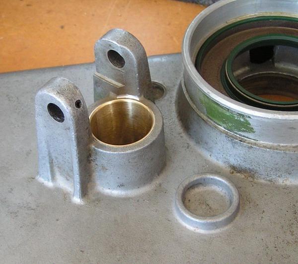

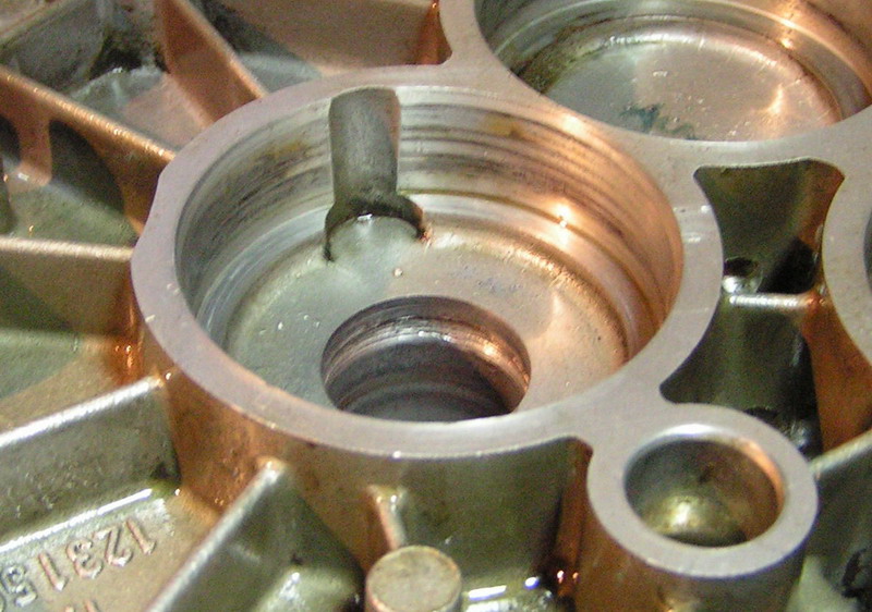

jepsen wrote: Wed Dec 22, 2021 12:33 pm Managed to get the washer #3 out with a small strong magnet
Thanks guys
So how good is the bore in the cover? I've had a couple of covers that required the bore to be sleeved:
clutch bore2.jpg (134.96 KiB) Viewed 1461 times
clutch bore.jpg (146.38 KiB) Viewed 1461 times
clutch bore 3.jpg (45.72 KiB) Viewed 1461 times
My local motorcycle-friendly engineering shop fixed them for OZ$50 each.
