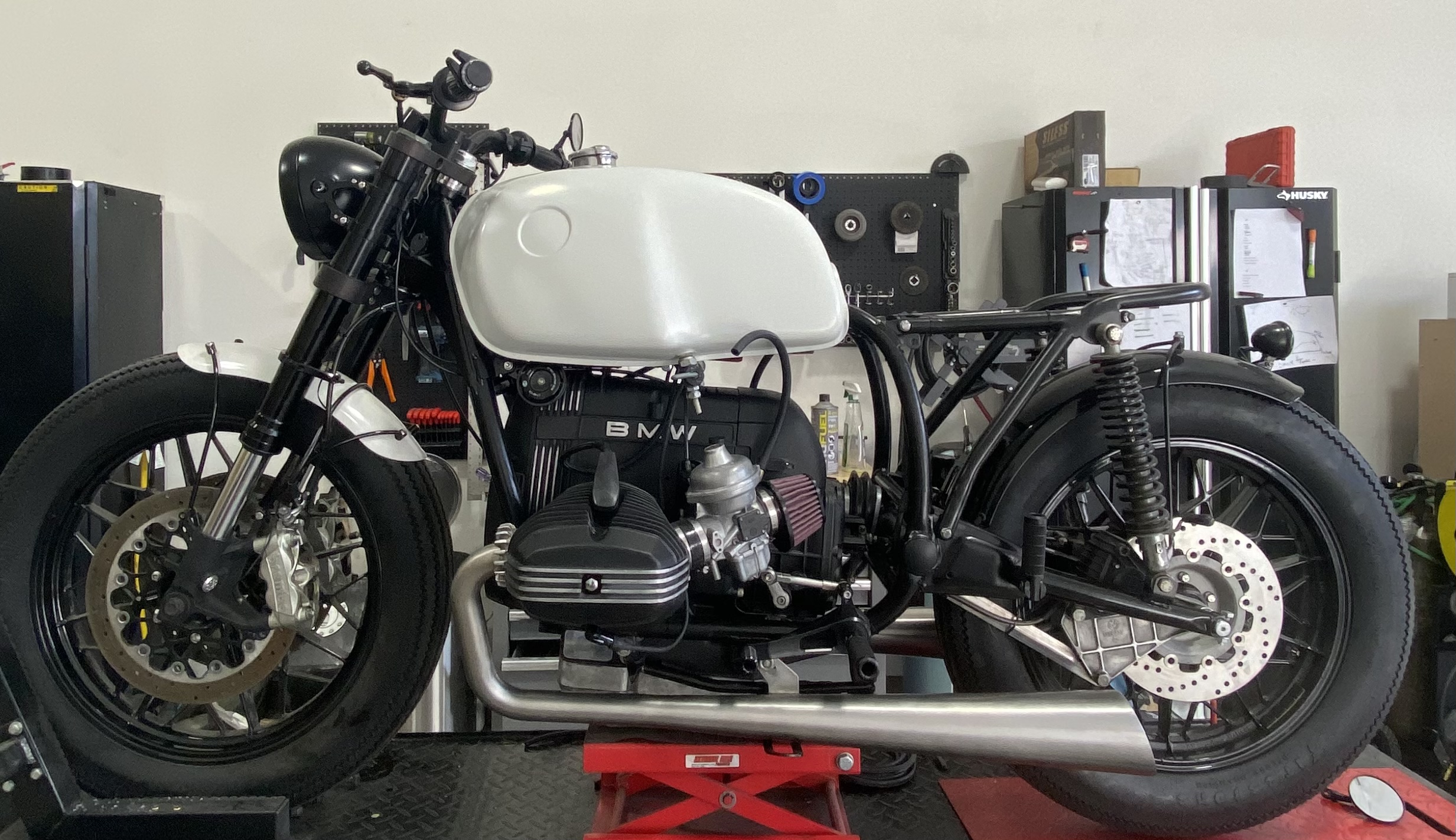

Here are a couple of side views of the old girl:
BRUN 03.jpg (437.43 KiB) Viewed 1597 times
BRUN 05.jpg (332.38 KiB) Viewed 1597 times

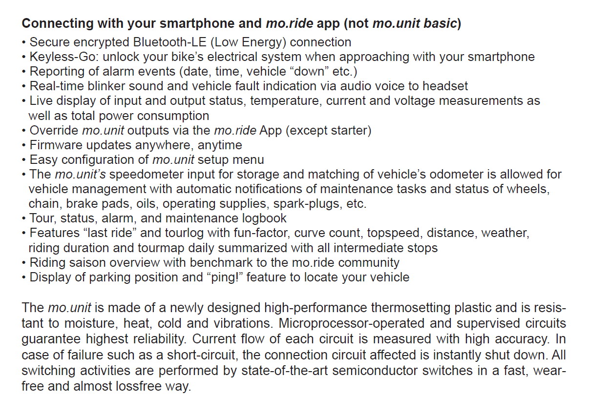

I've barely touched on some of the features of the Gadget. Here are a couple of pages from the manual:
The manual is available here: https://motogadget.com/shop/media/downl ... en_2.4.pdf
More later ...
