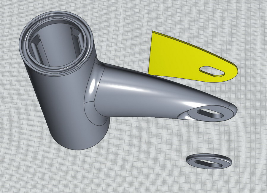

Thanks kmisterk. Yes, I'll be able to send you the STL files for the bucket, supports and other bits. Send me a PM and include your email address. My stuff is printed with ABS+ but there may be other options, particularly if you have access to a resin printer. ABS filament printing has its challenges and I had to do a lot of tweaking to get sufficient strength. The temp controlled enclosure, at 60C, made the difference in preventing warping during the print.

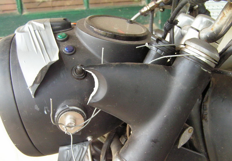

My first attempt at a printed bucket and ears went well for a couple of years but a trip in 2019 on the same bloody road - the Barry Way in southern NSW - when it was dry and very corrugated, saw the fronts of both ears break and the headlight dangling by its umbilical cord.
I redesigned the ears to include a groove for an o-ring at the top and made an aluminium reinforcing plate that is glued on with West System epoxy.
If by 'cluster' you mean the warning lights, those bits were also printed. More later ...
