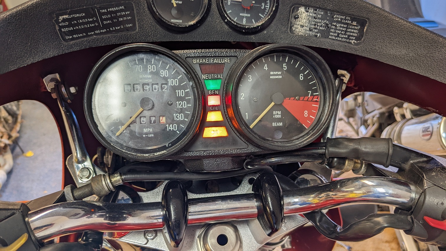

That's good! Exactly the lights you should see.
Yes, down for right and up for left on the indicators.
The wires need to be connected to the cap for the Brake Failure light to work.

Those lights look right for ignition on, engine not running. As for the brake failure, probably terminals are corroded. Looks it's a two-wire setup, with one wire going to ground and the other wire getting power from the ignition switch. Also looks like the power comes through the light in the instrument pod. You might have a burned out bulb in the speedo.

danielhowden wrote: Sat Oct 01, 2022 11:36 am Just checking - I've not worked on a BMW before. These lights look right for a stationary engine I think?
On the indicator switch by the throttle is down supposed to light the right indicators?
Lastly, I'm not getting the brake failure light to come on. I understand that if there is no fluid in the reservoir then it should come on, also if the wires are taken off it should come on right? Neither of these options bring the light on and I did check that the bulb was ok.
Thanks.
To test the Brake Failure light circuit is working with the ignition on remove the cap carefully from the master cylinder and lift the cap up the light should come on, its a warning that your brake fluid is getting low that's all.
