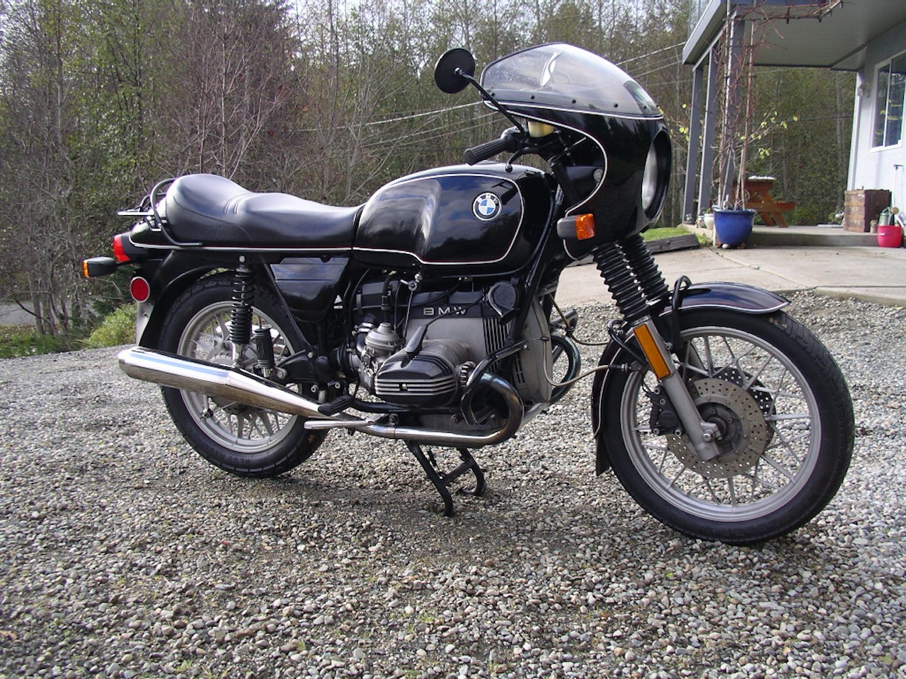

1984 R100 70,000K Original owner
My left boot gets oil on it when first riding. Once I've ridden for a while it stops.

Thanx guys! I guess I'll do a refresh on the top end this winter. It's never been touched, so It should come apart easily. I'll go through all my parts stash and see if the tower seals are still supple. I guess there is no way of knowing how long new seals have been stored anyway.

PS - You're bike looks effin' great without that dog ugly tank cover. Aren't you worried that your heirs won't want it after you croak, now that it's been exposed to UV rays?

It's a beautiful bike ZM. Good to see you're stilling using it.
