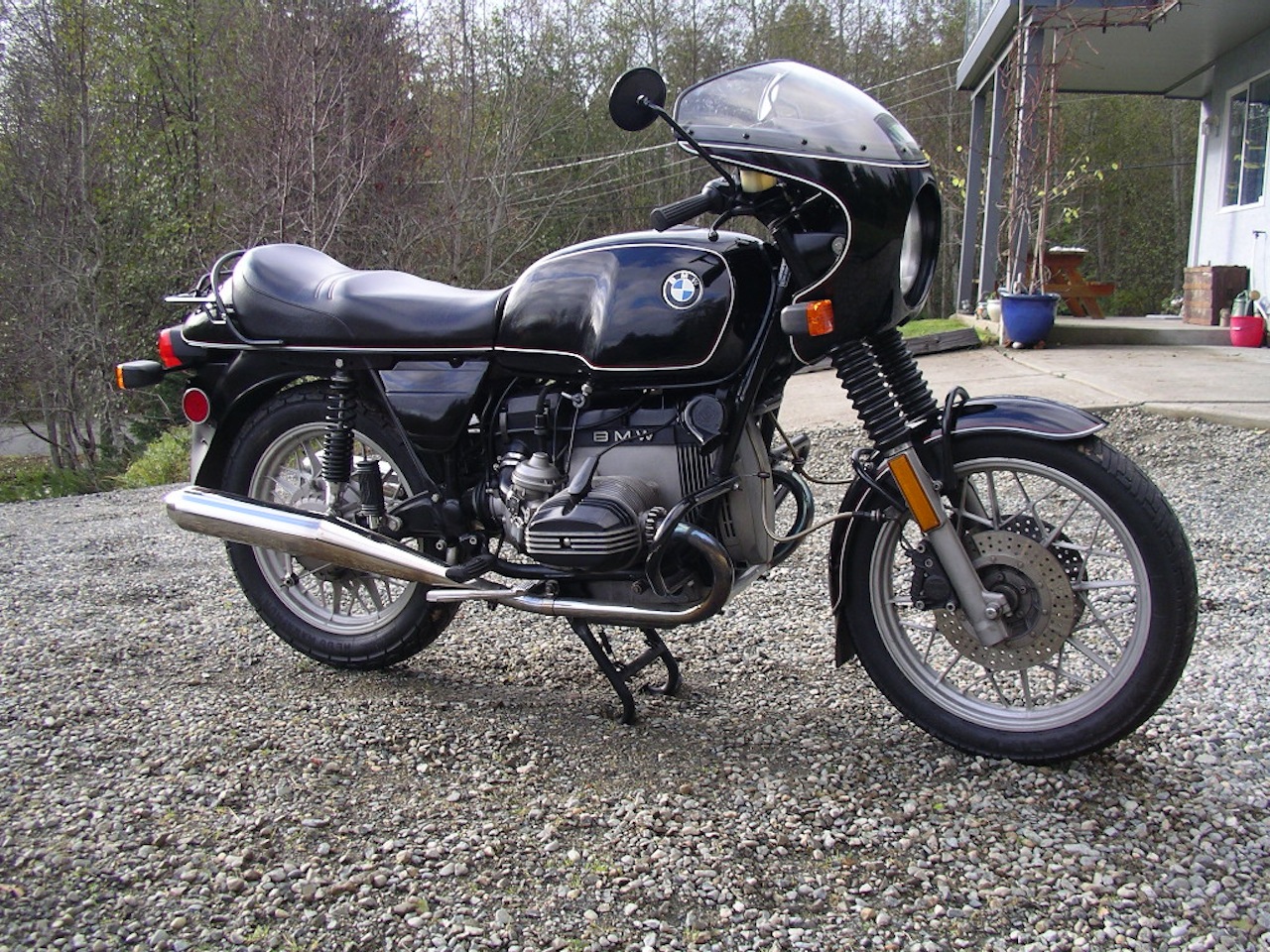

Thanx guys! I guess I'll do a refresh on the top end this winter. It's never been touched, so It should come apart easily. I'll go through all my parts stash and see if the tower seals are still supple. I guess there is no way of knowing how long new seals have been stored anyway.
IMGP2760 copy 2.JPG (627.49 KiB) Viewed 16465 times
Posts: 1133
Re: Pushrod towers leaking
Zombie Master wrote: Wed Aug 20, 2025 12:53 pm I guess I'll do a refresh on the top end this winter.
In the mean time...
Roll a piece of paper towel into a 4 inch long by 3/4 inch diameter 'cigar' and tightly pack it in (from underneath) between the main frame and the engine case, just below the pushrods seals. This costs nothing and can easily be replaced once saturated. It won't fix anything but It'll keep things clean by containing the leak until 'next winter'. It will be invisible even to knowledgeable spectators and admirers. A tampon might work just as well, but something about the string irks me.
PS - You're bike looks effin' great without that dog ugly tank cover. Aren't you worried that your heirs won't want it after you croak, now that it's been exposed to UV rays?
