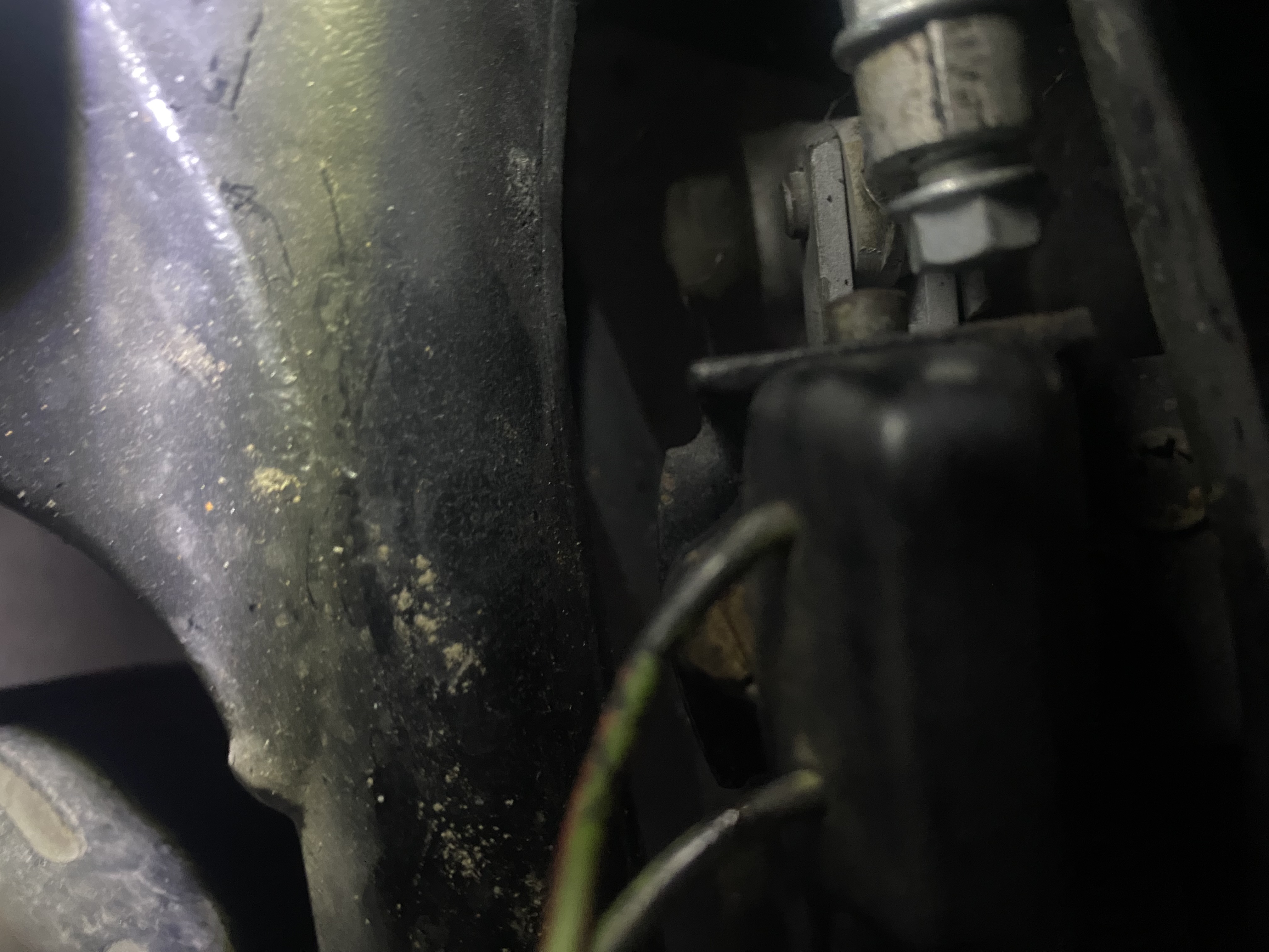

My 1979 R100Rs, cant align rear brake pedal with the switch activator, so brake light stays on always, is there any way to adjust the brake pedal mechanism ? The switch has a fixed bracket , no adjustment

Willcommen eriojas. Have you got all the spacers/fasteners? And in the correct location?

SteveD wrote: Fri Apr 04, 2025 10:20 pm [quote=eriojas post_id=136578 time=<a href="tel:1743818166">1743818166</a> user_id=13390]
[/quote]
eriojas wrote: Fri Apr 04, 2025 9:56 pm My 1979 R100Rs, cant align rear brake pedal with the switch activator, so brake light stays on always, is there any way to adjust the brake pedal mechanism ? The switch has a fixed bracket , no adjustment
