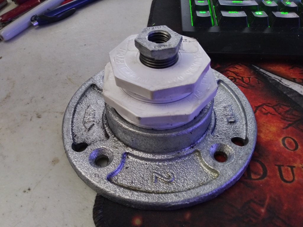

Actually, there are 3 seals. Crankshaft, Camshaft and tachometer drive seal. Since the front timing cover is pressed on over the crankshaft bearing you really need the special tool to safely remove the cover. It bolts on where the alt housing goes and there is a bolt in the center that mates with the nose of the crankshaft. Tightening the bolt removes the cover evenly and easily. Here is a pic of the tool I made to do this. I went ahead and replaced the timing chain, tensioner and spring while I was in there.

That's a cool cover pulling tool, but I would not let it's absence slow you down.
I've removed hundreds (literally) of these covers over the decades with ease.
A touch of heat around the bearing housing and they always pop right off with a few light taps of a plastic hammer.
