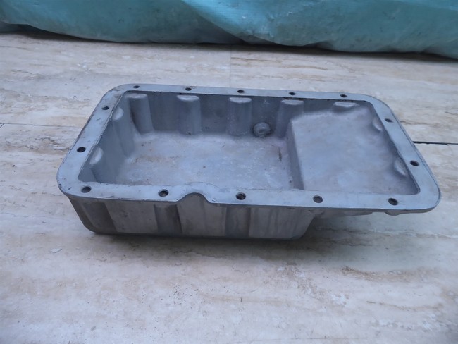

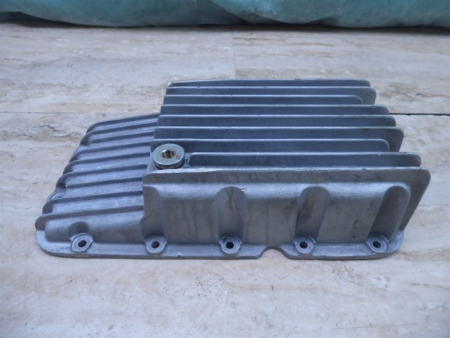

I've got pans like this on my R75/6 and my R100RS and will likely get one for my R100/7 sometime:
They clear the centerstands just fine. Two crossbars on the stands on these bikes.
I put 3 full quarts in and it will show about 1/2 quart low on the dipstick. This is a good thing as there's a wee spot more air volume which makes for maybe a tiny bit less stress on the breathing apparatus.
I think the current version is made by MAC.
Edit--this pic includes the critical pickup extension:
You'll need a second pickup gasket. Install the pickup with green Loctite and use hardened washers if you can on the extension where the bolt heads bear on it. On the R75 I had to spot face the extension where a previous mechanic had installed it without washers and it was chewed up a bit.

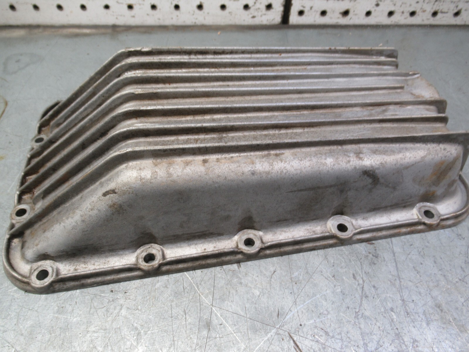

melville wrote: ↑Thu Jan 22, 2026 12:18 am I've got pans like this on my R75/6 and my R100RS and will likely get one for my R100/7 sometime:
So this type of pan is a no go?
- s-l1600.jpg (379.97 KiB) Viewed 6466 times
Re: Deep Oil Pan
Yeah, I'm pretty sure the early centerstands will hit that.
- Posts: 1405
Re: Deep Oil Pan
Absolutely correct... In fact I think that is why, in 1980, BMW moved away from the centre stand they had used from 1969, replacing it with the much weaker and wear prone stand that required a redesign around a year later (which didn't help much) and was completely revamped for the Monoshock models. Smacks of Right Hand ignorance of Left Hand requirements.
